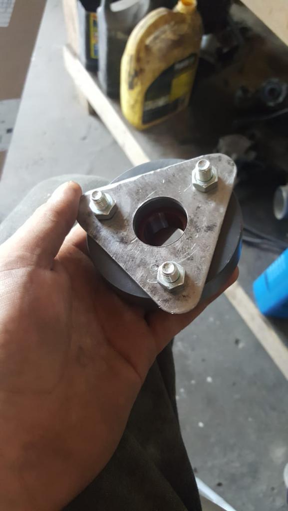

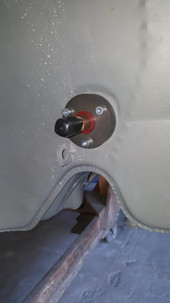

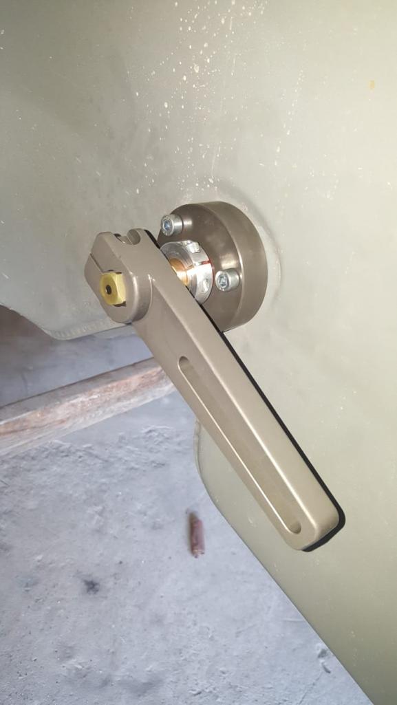

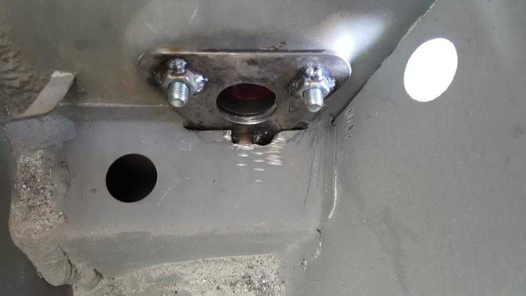

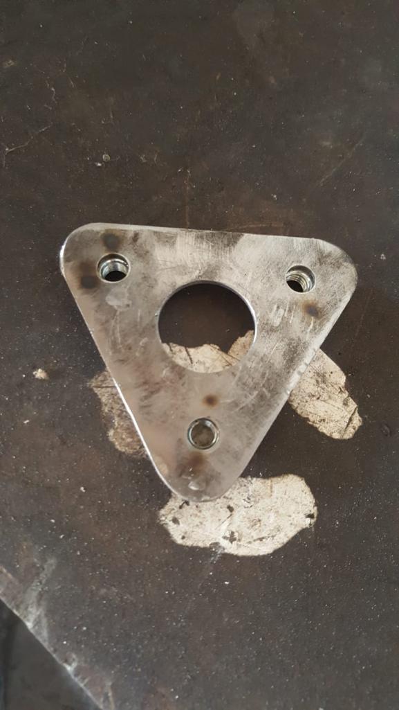

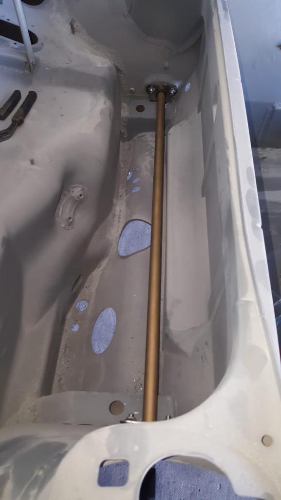

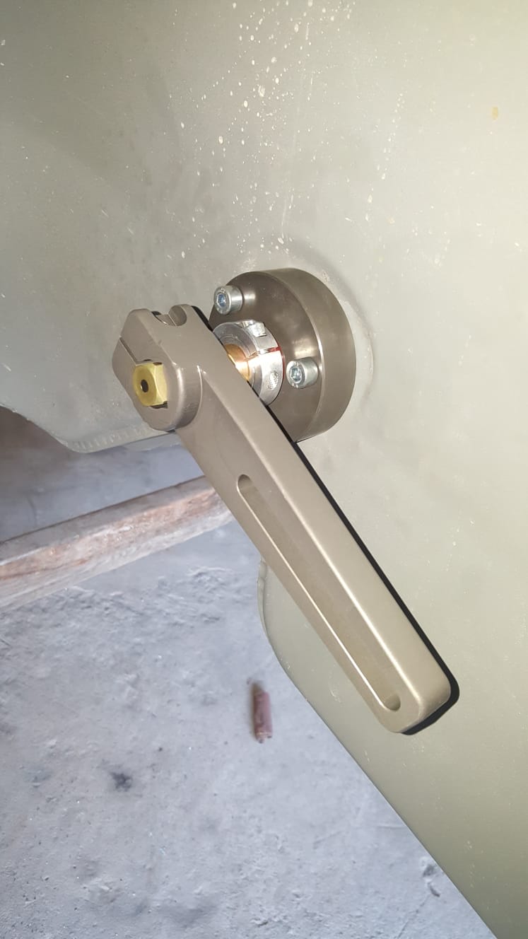

Another thing on my to do list before paint was the front sway bar modification. I bought it from GR German Parts Restoration. Made the bracket for the inner fender well, and then drilled the holes to fit the sway bar. Here I'm checking the alignment prior to welding the bracket on.
