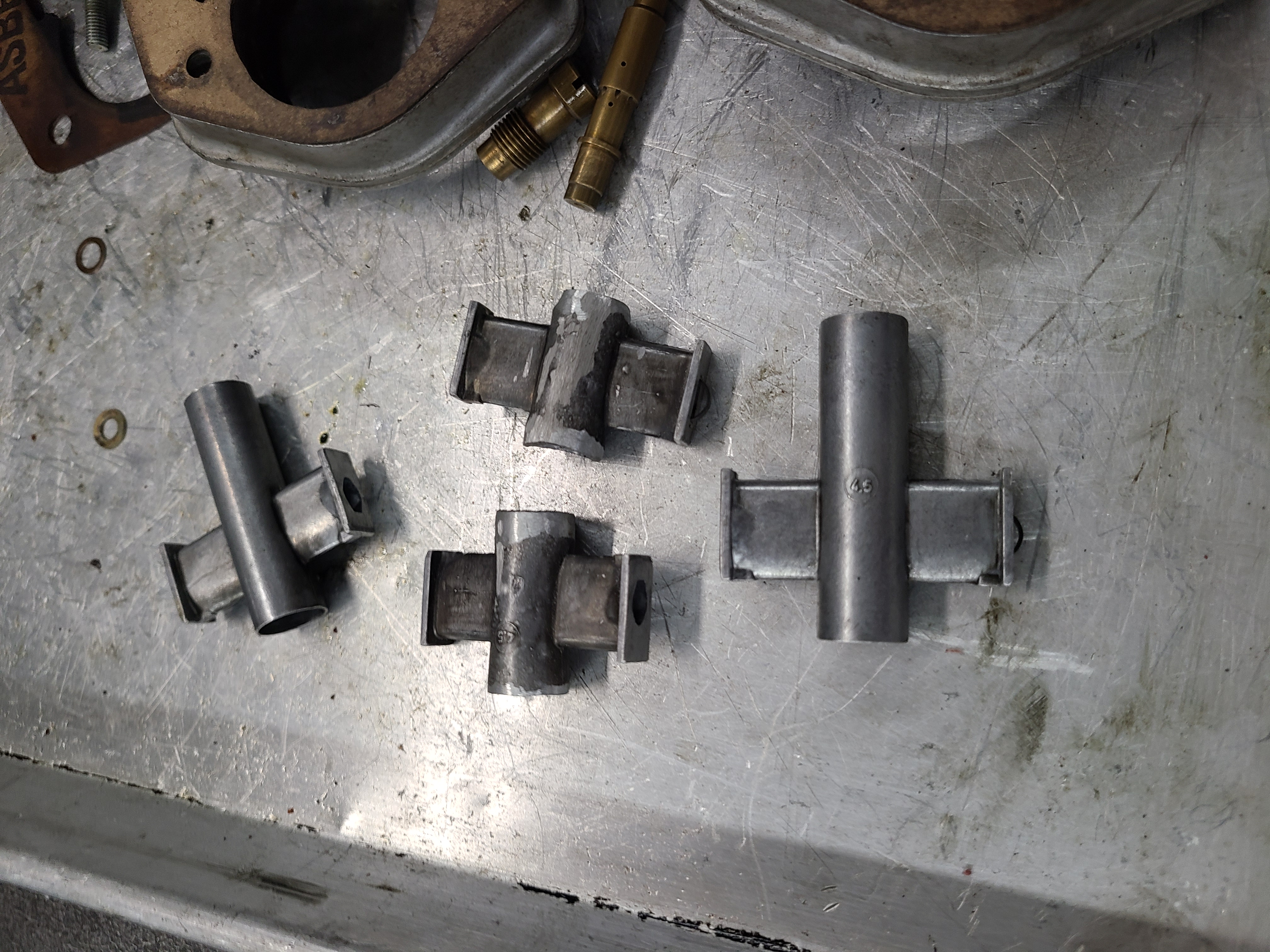

My car came with dual Weber 40 IDF 42/43 4C carbs. Put on long before I got involved. The issue is that due to many backfires through the years and too many owners, the aux venturis have been melted down enough to be useless. A mechanic I am using tried to sleeve them but it did not work.
It looks like these are very old carbs and those parts are NLA. I have dimensions if anyone has some to offer. So I either need to find some in a parts stash. Or buy a used carb or two. Or buy new carbs. This is all just to get it running to see if I need the engine rebuilt. A very long frustrating story... I'll post these in WTB but I need info and suggestions so I am posting here too. Attached thumbnail(s) |

check with this guy, great price and delivery
al... Sep 3 2021, 03:00 PM
zig-n-zag You have the late style 40IDF-XE, by the 42/43 C4 ... Sep 3 2021, 09:24 PM
zig-n-zag The 44IDF aux venturis will fit right in your carb... Sep 4 2021, 04:41 PM
