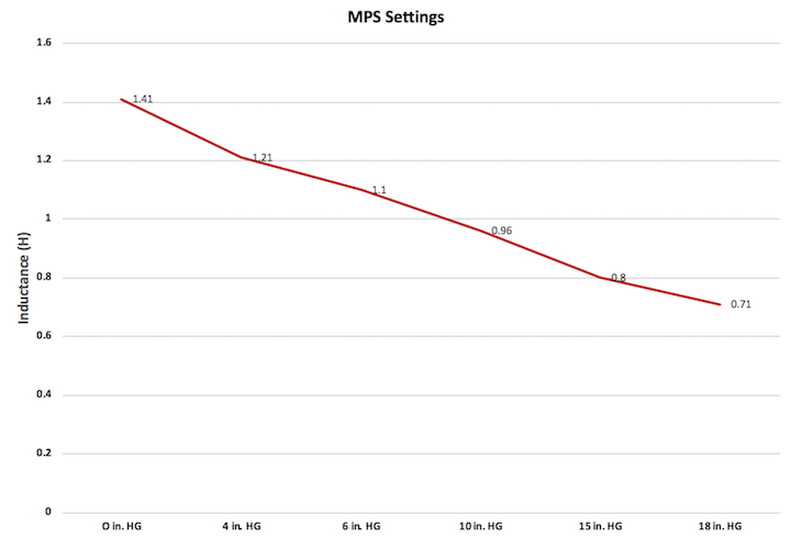

There appeared to be no way to change the slope of the MPS Response curve in the region from 15 In-Hg to P'. And, I was experiencing the same problem that Demick posted about years ago in the thread linked above. Namely, the AFR would become too lean under moderate-load conditions across all RPM's, like this (from Demick's post):
(IMG:http://www.914world.com/bbs2/uploads/post-2-1096387565.jpg)
To fix the lean condition around 6-8 In-Hg, it's really necessary to change the slope of the MPS response curve, not just raise or lower the whole curve.
However, there appears to be hope. It seems that the MPS inductance is not simply linear WRT manifold pressure in the 15 In-Hg to P' region. I speculate that this may be due to non-linearity in the MPS Inductance across its range of movement and/or the effect of the MPS spring. The result is that the curve seems to look more like the "Chart B" sketch above. And, the effect of turning the MPS inner screw isn't really raising or lower the entire curve, but rather shifting the Chart B curve left/right. (Chart B is a really rough sketch, and may even have the convexity backwards. For a more quantitative look, see below.)
I measured the inductance of my MPS at two different inner-screw settings: The red curve is the MPS tuned to pbanders's values corrected for 700 Torr ambient pressure. The blue curve represents an attempt to richen the AFR by turning the inner screw CCW.
As you can see, the slope of the red curve is steeper than the blue curve in this region. Apparently, turning the inner screw CCW has the effect of reducing the slope by raising the right end, rather than raising the whole curve.
I'm surprised that the curves cross around 7 In-Hg and that the blue curve value is less than the red curve value at the left side of the chart. This may be due to the effect of the part-load stop coming into play near P', measurement error, or something else. (IMG:style_emoticons/default/confused24.gif)
The salient point, however, is that adjusting the inner screw affects the slope of the curve, whereas presumably adjusting the fuel pressure does not.

I know I'm late to the party- this thread is over a year old, but I finally got around to picking up an inductance meter (The same Wavetek LC55 that Anders used, not the newer 'A' version) and measured my MPS (043). I had previously calibrated it by measuring AFR only and the car drives great and AFR #s are good, although admittedly I'm not sure I'm setting AFR for part load correctly- not sure where in the RPMs/what speed (& flat or incline) I should be focusing on for part load AFR measurement. The shape of the curve from 15 in. Hg to 6 in. Hg makes me think my adjustment might be off.
I also have a spare MPS (let's call it MPS #2) and decided to calibrate it for the 'stock' numbers per Anders site (and adjusting for elevation). After calibration it was too lean and the car wouldn't start. I then adjusted it to match MPS #1's inductance settings. Afterwards, it started and idled ok but would stall on acceleration. I double checked the settings with the meter, and sure enough both MPSs matched. (IMG:style_emoticons/default/confused24.gif)
After adjusting the outer screw independent of the inner screw (and readjusting the inner screw accordingly), i got it to idle and accelerate without stalling.
I need to drive the car with #2 installed and adjust for AFR. Once I've done that I'll be curious to see what the inductance #s are on it. I don't understand why 2 MPSs with the same inductance settings would lead to different AFR#s.
