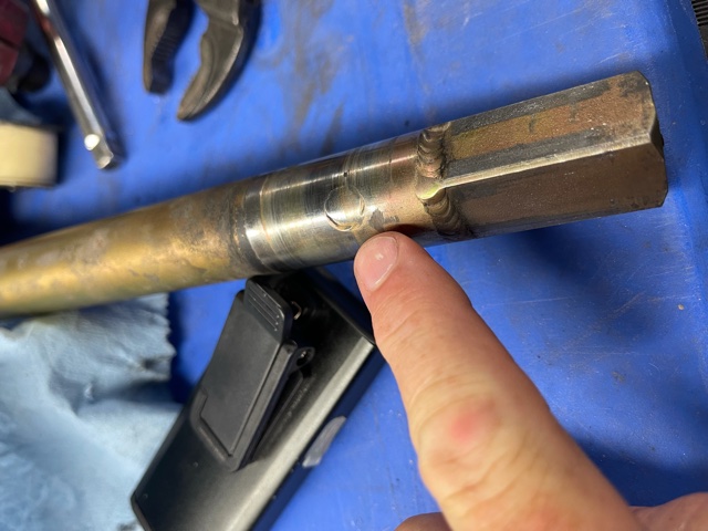

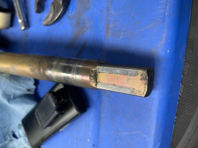

I thought I'd share these pics. I never believed that a sway-bar would break. Anyone else seen this before?

hollow hybred..or lessbred..True hollows are through hollow...I am sure you will get free replacement..lesser design..

QUOTE(sixnotfour @ Sep 2 2021, 10:10 PM) *
Hadn't noticed that in the pics. I'd agree the fact that it broke at the interface of the hollow bar and the fabricated end, probably isn't a coincidence.
Is the square end welded to the hollow bar?

stownsen914   I'd guess it failed at the weld (or right next...   Sep 5 2021, 06:08 AM
