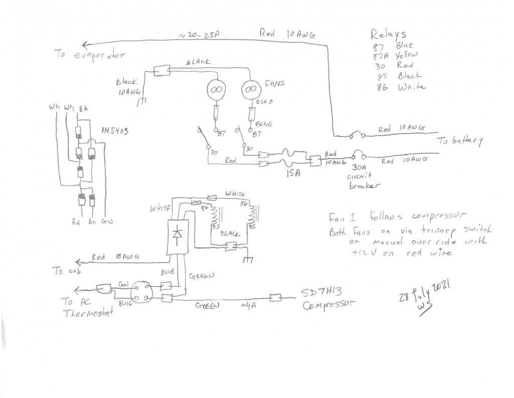

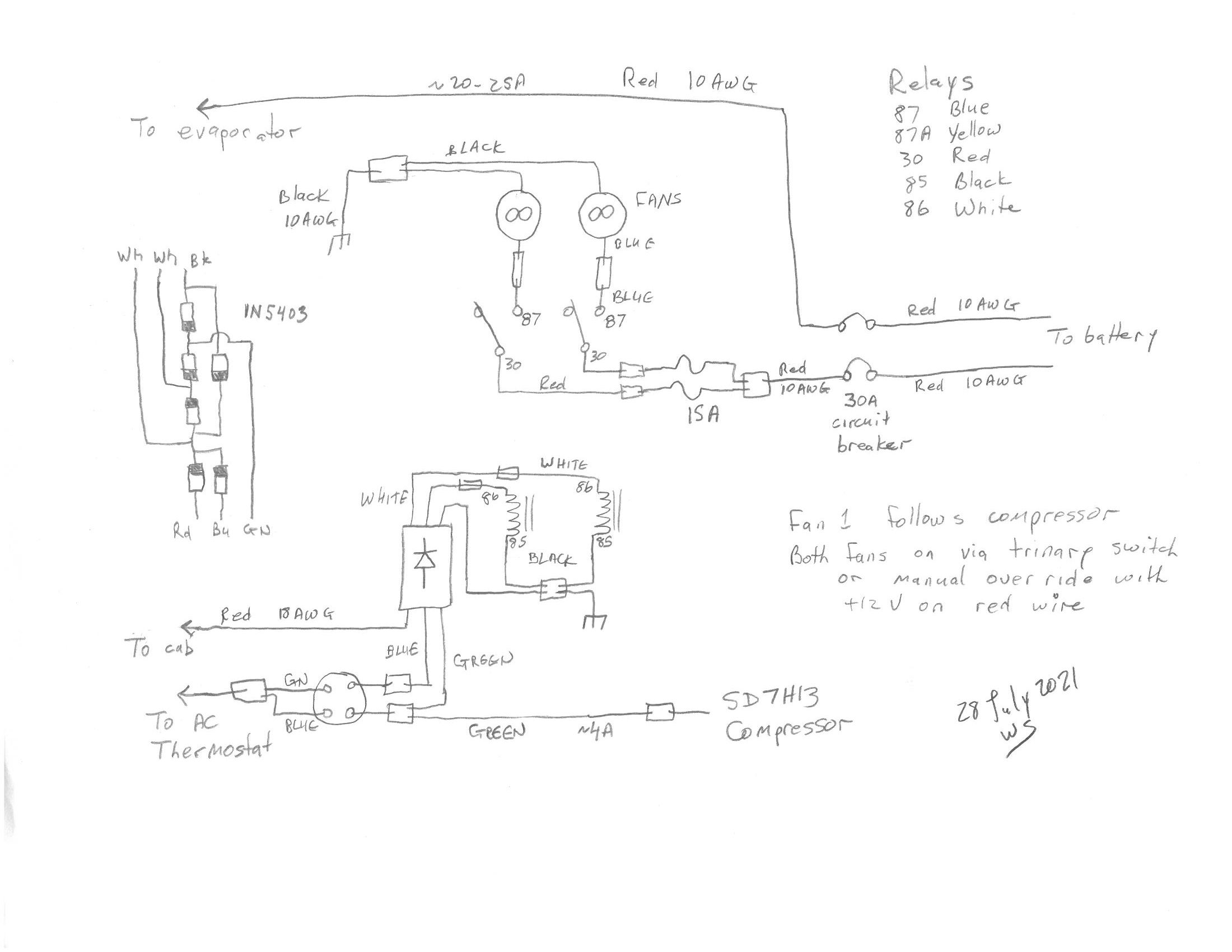

Here's the diagram I asked Mark to follow for my AC install. The diode matrix controls the two condenser fan relays. One fan follows the compressor. The other fan will come on when pressure raises on the trinary switch or via a manual switch in the cab.
