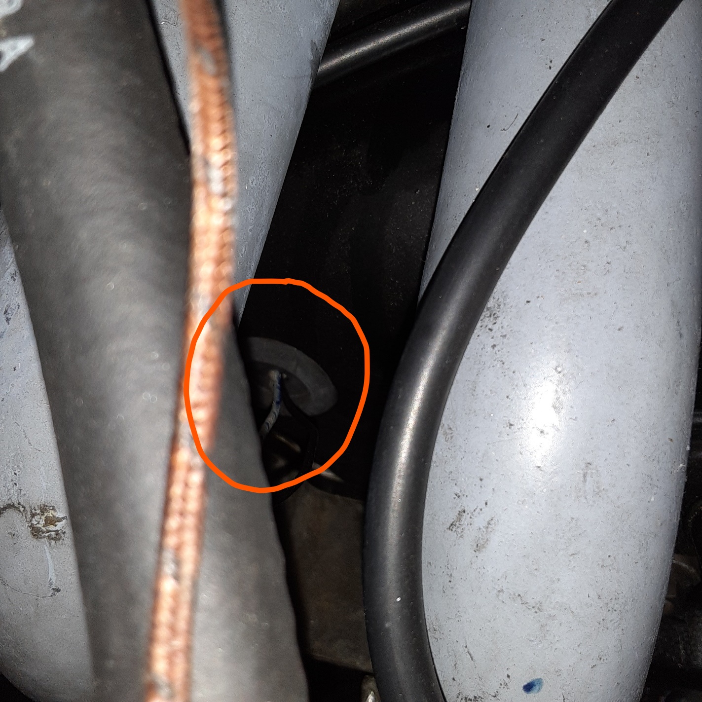

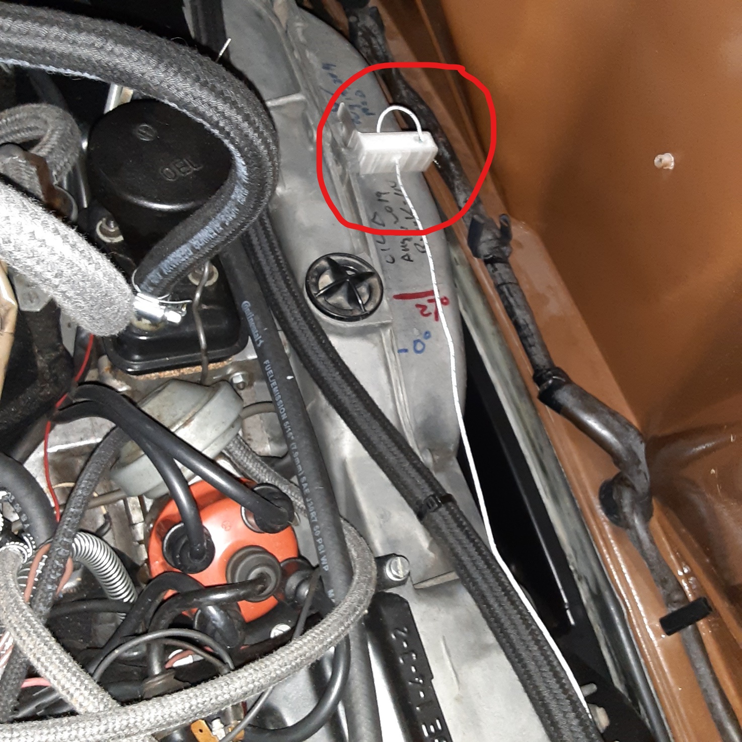

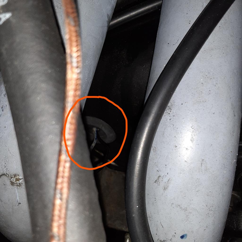

Even though my scoop experiments to date have been yielded poor results, I felt like I should give an update; mostly cause all the input I received was useful in trying to improve what already is adequate cooling.
Based on your input I put thermocouples at the fan inlet and between the tin and engine where the stock CHT is.
Today the ambient temperature was about 75F. I ran with and without the scoop. My fan inlet temperature was about 100F and the CHT ran between 110 to 120F depending upon rpm.
With the engine off and parked in my garage the temperature started to climb. I didn't watch it till the temperature rise reversed, but the fan probe (basically engine compartment) got to 135 F and the probe by the CHT got to about 270F. I took a mini leaf blower and blew into my scoop getting my fan probe to drop about 15F (to about 120F); and yes, it did rise back to 135F after I removed the leaf blower.
The scoop I used was resigned for better flow and directed air to the fan, but I think it still lacks efficiency and capacity to make a difference. Those side vents are awfully small for 914's fan compacity and based on some of the comments it seems the air flow from the vents to the fan are poor.
Oh well, back to the drawing board. (IMG:style_emoticons/default/confused24.gif)
