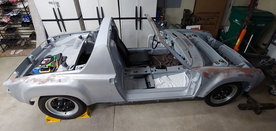

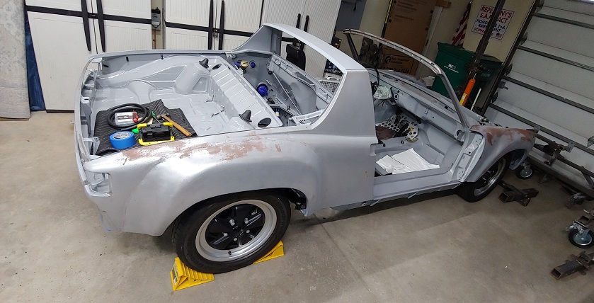

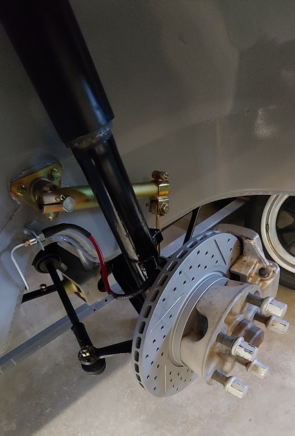

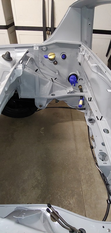

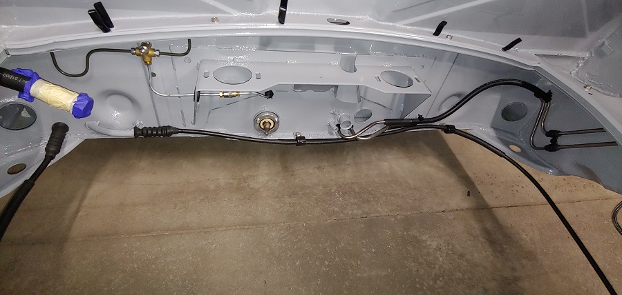

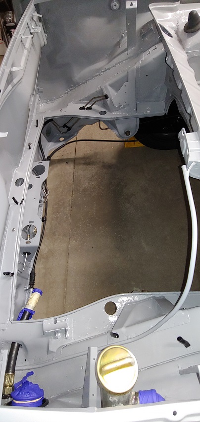

We've been working away here.. Got the brakes installed, adjusted, and bled. My brother went with a 19 mm ATE master, New brake lines from PMB, SS flex lines, Aluminum front 911 S calipers w/SS pistons, and PMB rebuilt 6 calipers to GT spec.
Wrapped up a few suspension items as well. Got the SS fuel lines installed. Local auto parts store was out of 3/8'' fuel hose so got some of that coming in.
Got the factory 6 oil tank installed. Actually went in pretty easy.. oh wait did I say easy... I forgot to remove the engine heater fan holder in the left engine shelf.. Yup it's in the way and can't mount the oil filter now.. Great, hopefully I do not wreck the fresh paint getting it out of there. Otherwise my brothers 914 is off the rotisserie and back on it's wheels. Only took 8 years... (IMG:style_emoticons/default/blink.gif) (IMG:style_emoticons/default/wacko.gif)
