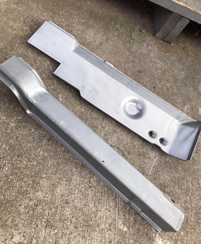

Literati914   Received a couple more items from RD, time to fini...   Sep 12 2021, 09:09 AM
