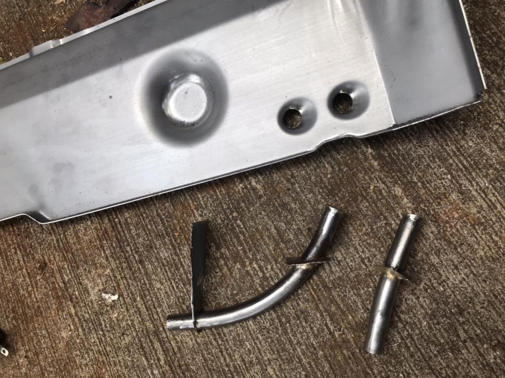

So next up.. the driver’s side inner. This time I popped holes around the perimeter for spot welds, with a convenient air tool I forgot I had (harbor freight). Before proceeding I needed to separate the ebrake tube from inner and outer firewalls:

Literati914   So next up.. the driver’s side inner. This time ...   Sep 12 2021, 09:17 AM
Literati914   Drivers side inner wall with holes ready to be wel...   Sep 12 2021, 09:23 AM
