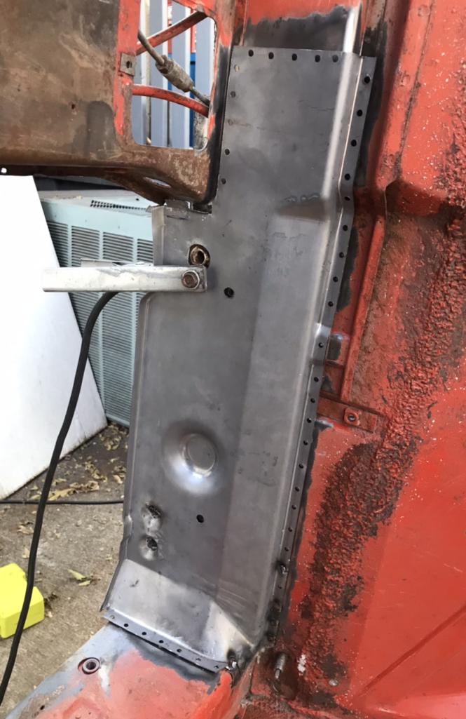

Literati914   So next up.. the driver’s side inner. This time ...   Sep 12 2021, 09:17 AM
Literati914   Drivers side inner wall with holes ready to be wel...   Sep 12 2021, 09:23 AM
