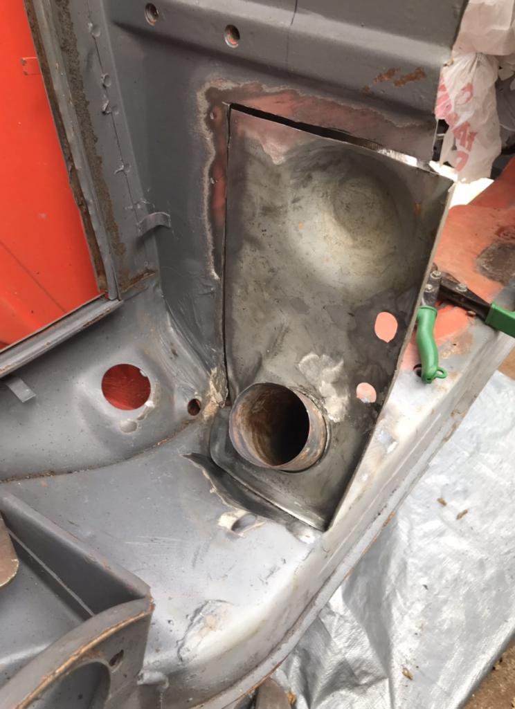

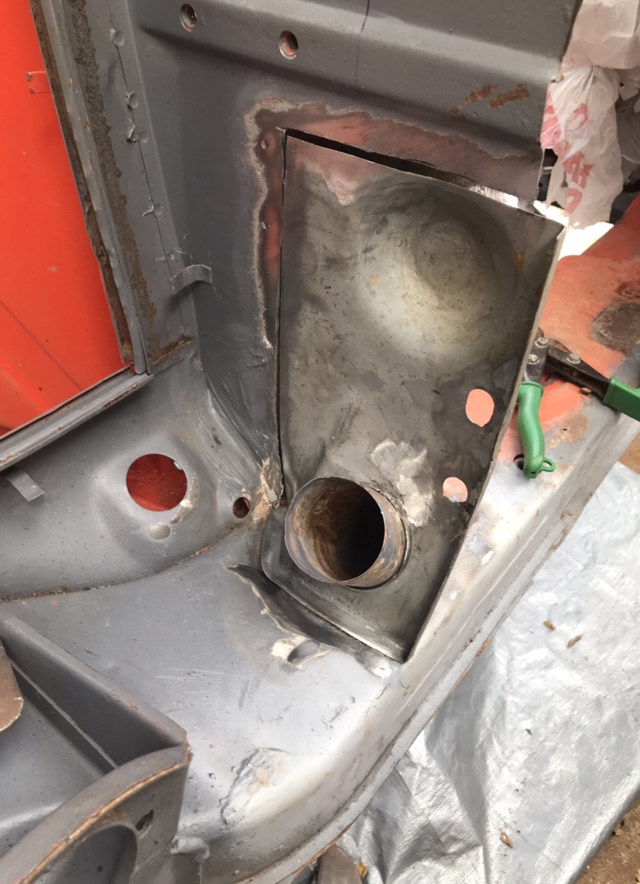

The rear DS wall repair was more complicated, needed to do it in a couple of sections. Here’s the first part.

Literati914   The rear DS wall repair was more complicated, need...   Sep 12 2021, 09:29 AM
