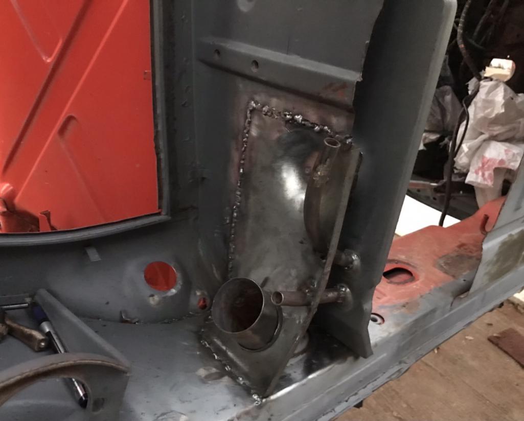

Here you can see where the original ebrake tubes are reinstalled and to get this to happen I kind of had to install the front and rear firewall at the same time on the drivers side.

Literati914   Here you can see where the original ebrake tubes a...   Sep 12 2021, 09:35 AM
