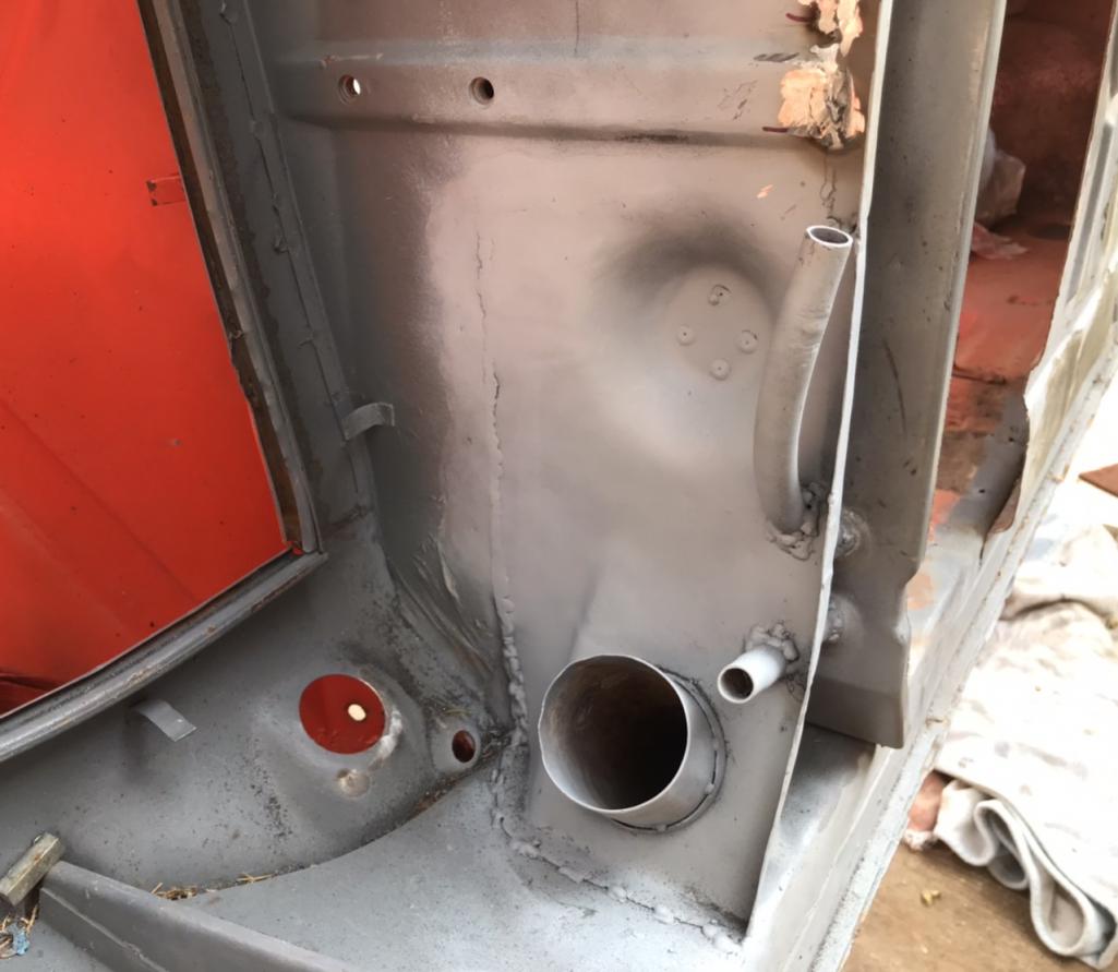

Literati914   Received a couple more items from RD, time to fini...   Sep 12 2021, 09:09 AM
Literati914   So next up.. the driver’s side inner. This time ...   Sep 12 2021, 09:17 AM
Literati914   Drivers side inner wall with holes ready to be wel...   Sep 12 2021, 09:23 AM
Literati914   The rear DS wall repair was more complicated, need...   Sep 12 2021, 09:29 AM
Literati914   Here you can see where the original ebrake tubes a...   Sep 12 2021, 09:35 AM
Literati914   …I’ll go back and dress the weld and make thin...   Sep 12 2021, 09:53 AM
