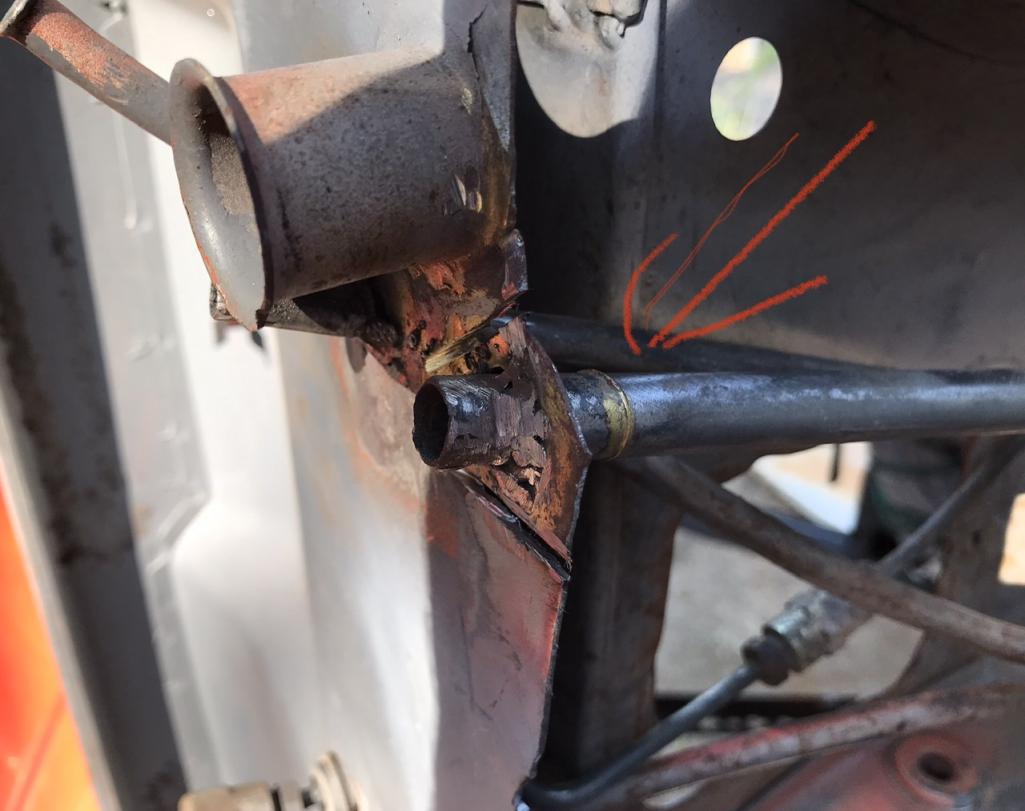

Ok so I’ve realized that when I retacked the clutch tube in place, that it was not in the right place.. it’s too far inward and not sticking out into the engine compartment enough. There is a bracket midways thru the tunnel that has broken loose and I will need to repair. I can see a brass ring around the clutch tube where it should meet the firewall (see the arrow in the pic). I will repair the inner tunnel bracket later. So ive cut the FW around the clutch tube, cleaned up the tube and will be correcting the tubes placement. Glad to do this cause those welds around the tube were kinda crappy looking.

Literati914   Ok so I’ve realized that when I retacked the clu...   Sep 12 2021, 10:14 AM
Literati914   …tube released   Sep 12 2021, 10:16 AM
Literati914   .. and cleaned   Sep 12 2021, 10:18 AM
Literati914   And a shot showing the remaining gap that needs fi...   Sep 12 2021, 10:31 AM
Literati914   Fabricated a panel and tacked it in.. in this pic ...   Sep 12 2021, 10:42 AM
