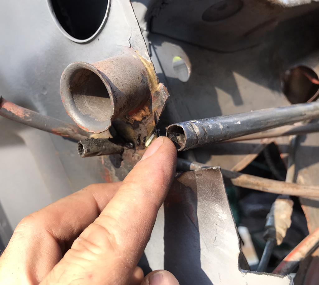

Literati914   Ok so today I removed the rear under side of the t...   Aug 16 2021, 09:06 PM
Literati914   Very Loose clutch tube   Aug 16 2021, 09:13 PM
Literati914   ..both repaired   Aug 16 2021, 09:15 PM
Literati914   Here you can see marks for the cuts I made at the ...   Aug 16 2021, 09:20 PM

Literati914   Ok so I’ve realized that when I retacked the clu...   Sep 12 2021, 10:14 AM
Literati914   …tube released   Sep 12 2021, 10:16 AM
Literati914   .. and cleaned   Sep 12 2021, 10:18 AM
Literati914   And a shot showing the remaining gap that needs fi...   Sep 12 2021, 10:31 AM
