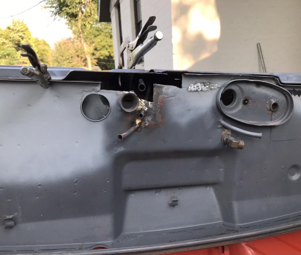

Literati914   Ok so I’ve realized that when I retacked the clu...   Sep 12 2021, 10:14 AM
Literati914   …tube released   Sep 12 2021, 10:16 AM
Literati914   .. and cleaned   Sep 12 2021, 10:18 AM
Literati914   And a shot showing the remaining gap that needs fi...   Sep 12 2021, 10:31 AM
