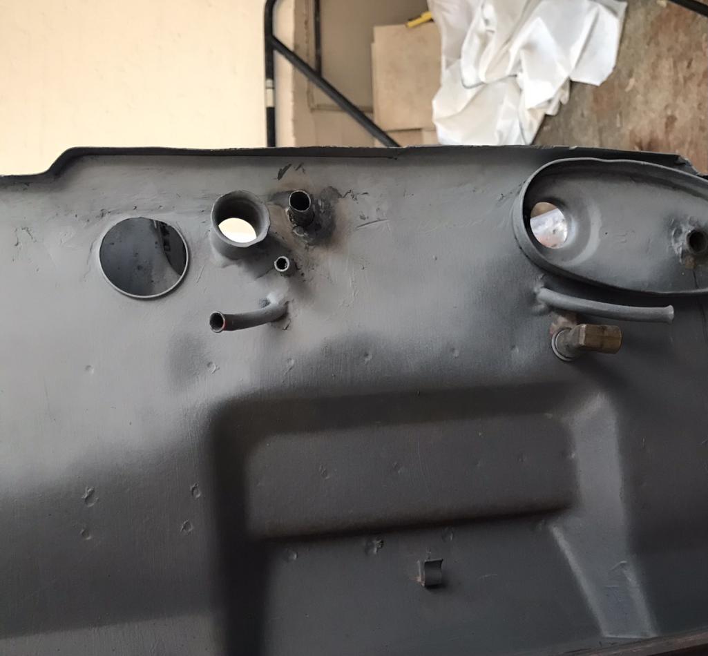

Literati914   Welds knocked down and lightly primed   Sep 12 2021, 06:27 PM
