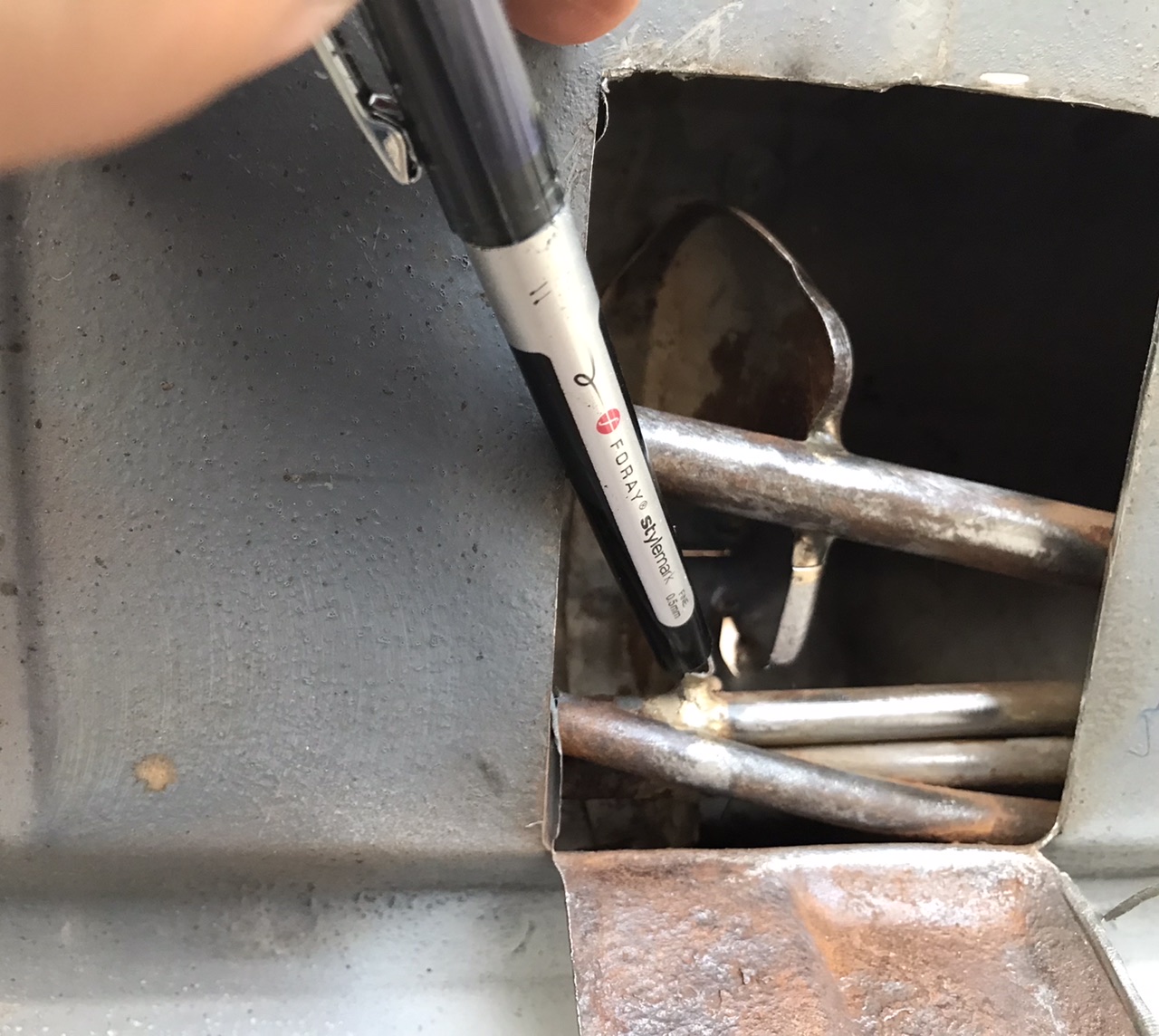

Now to tackle the loose clutch tube bracket midway down the tunnel.. in this pic a small section of the tunnel has been peeled back and my pen is pointing to where the bracket snapped, and pulled the tube towards the front of the car.

Literati914   Ok so I’ve realized that when I retacked the clu...   Sep 12 2021, 10:14 AM
Literati914   …tube released   Sep 12 2021, 10:16 AM
Literati914   .. and cleaned   Sep 12 2021, 10:18 AM
Literati914   And a shot showing the remaining gap that needs fi...   Sep 12 2021, 10:31 AM
Literati914   Fabricated a panel and tacked it in.. in this pic ...   Sep 12 2021, 10:42 AM

Literati914   Now to tackle the loose clutch tube bracket midway...   Sep 12 2021, 06:31 PM
Literati914   Bracket realigned and rewelded… I didn’t shoot...   Sep 12 2021, 06:36 PM
Literati914   Closed up, worked down and lightly primed   Sep 12 2021, 06:36 PM
