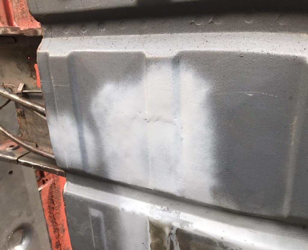

Literati914   Welds knocked down and lightly primed   Sep 12 2021, 06:27 PM
Literati914   Now to tackle the loose clutch tube bracket midway...   Sep 12 2021, 06:31 PM
Literati914   Bracket realigned and rewelded… I didn’t shoot...   Sep 12 2021, 06:36 PM
Literati914   Closed up, worked down and lightly primed   Sep 12 2021, 06:36 PM
