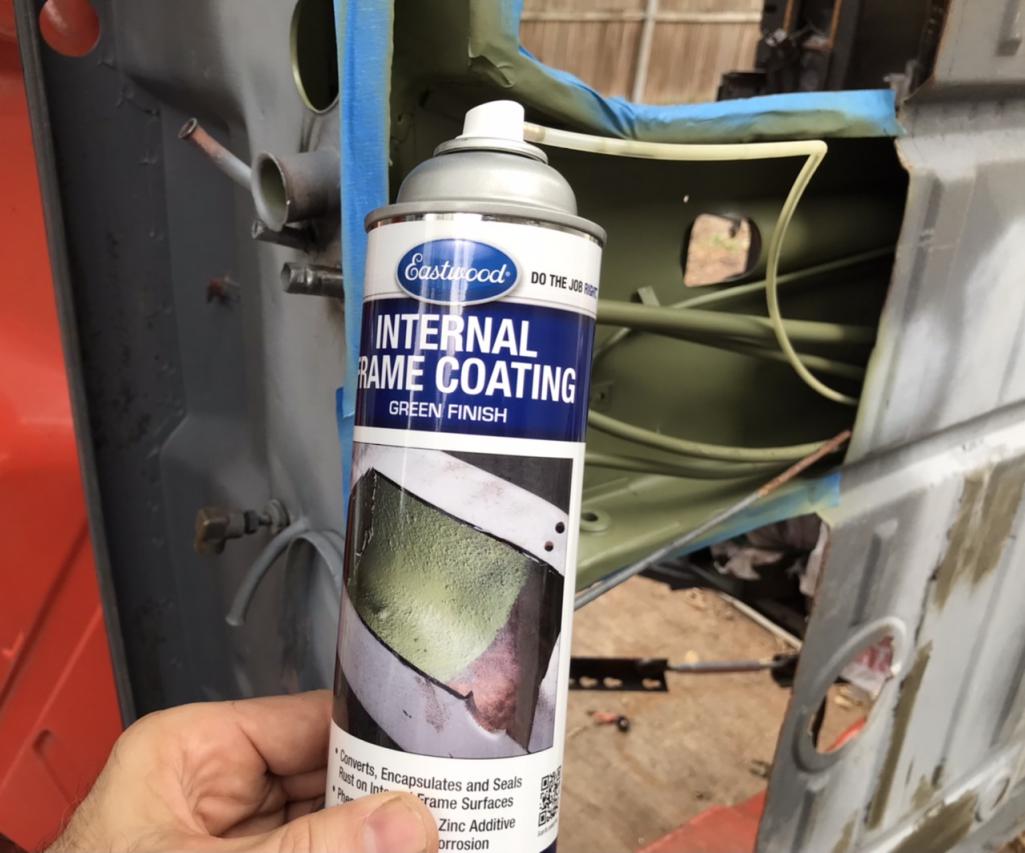

Literati914   I attached the flexible nozzle to a long flexy thi...   Sep 13 2021, 03:19 PM
Literati914   Done   Sep 13 2021, 03:20 PM
Literati914   I’ve got this stuff running out of the longs but...   Sep 13 2021, 03:24 PM
