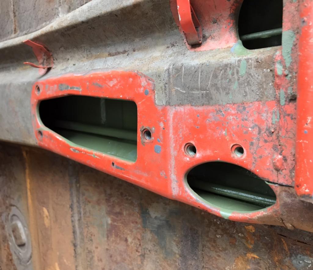

I’ve got this stuff running out of the longs but could only do so much with the heater tubes installed. Still though I think I got it in the most significant areas, around where the firewalls intersect. Here’s the tunnel, topside.
