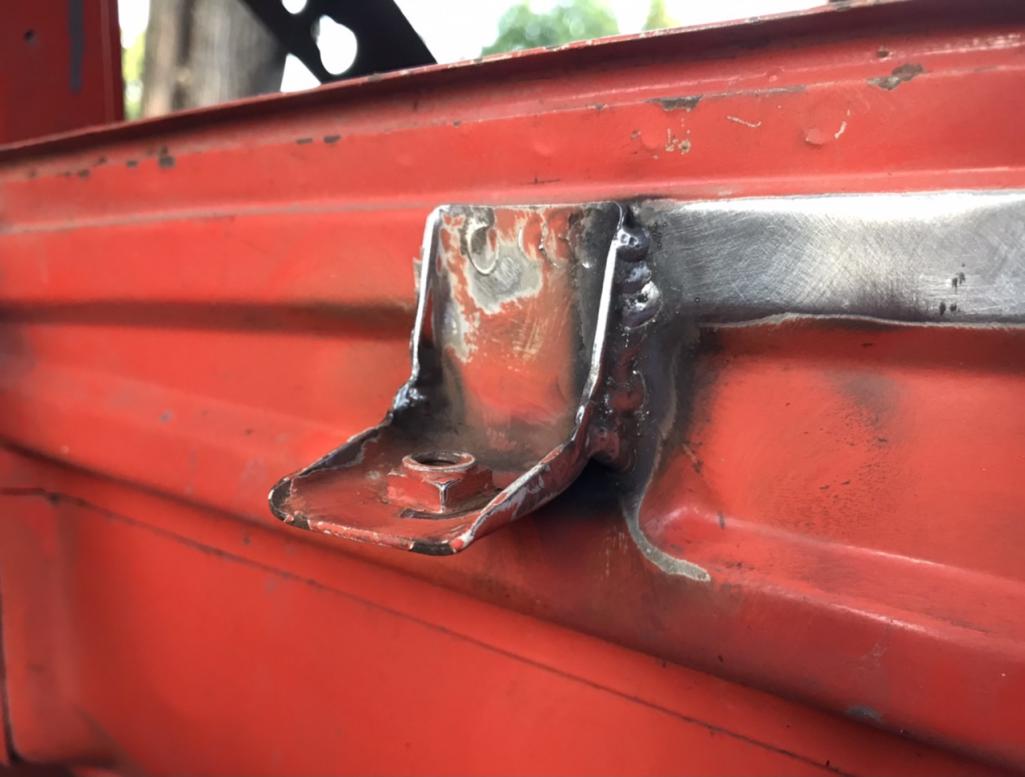

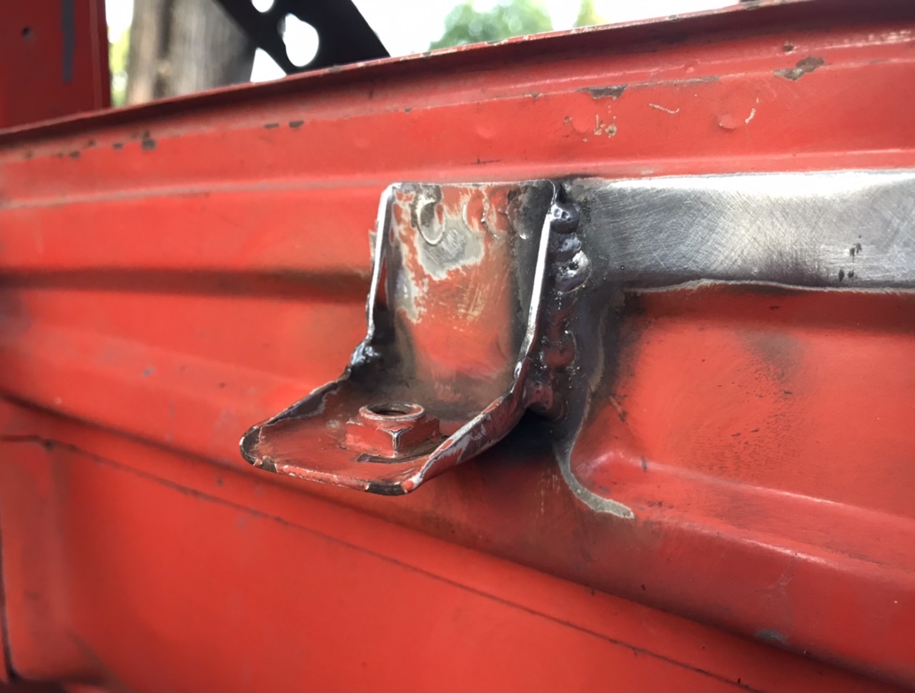

Wanted to polish off a bottle .. no, not that kinda bottle - welding gas! So I did some preventative work to the hinge brackets, both sides (engine lid to body).
