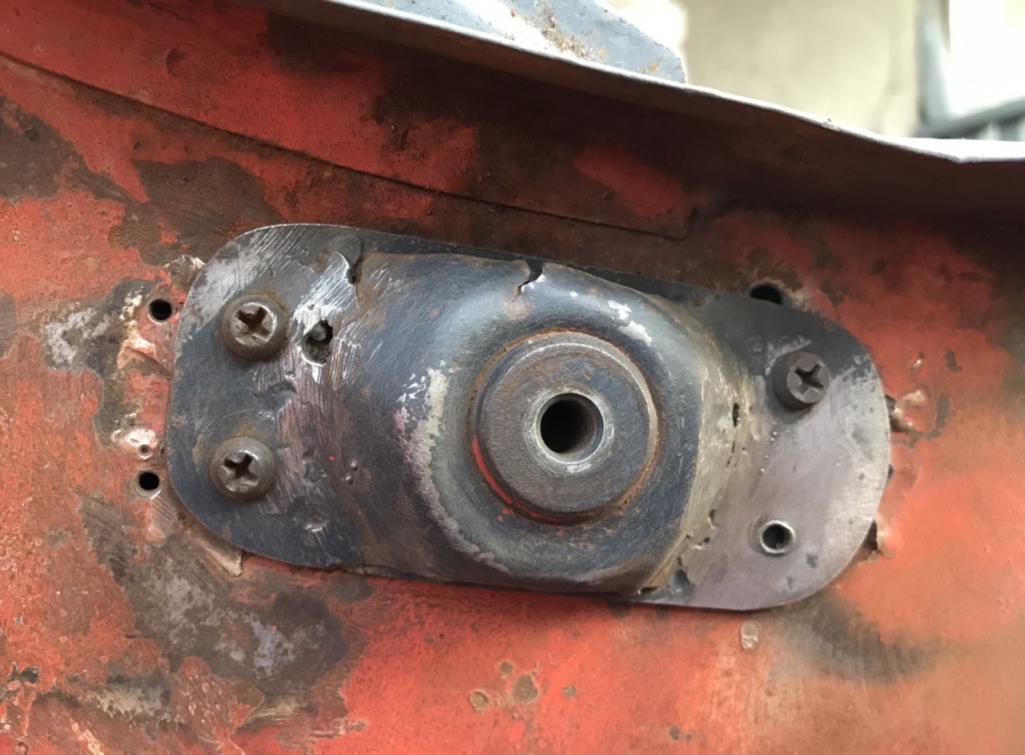

Does anyone know if there is a reference measurement for the rear deck lid hinge mount… mine as all over the place on the passenger’s side. Looks like it’s been moved a couple of times and I want to weld it in, get rid of those screws .. take a look and advise please:
I am NOT a body man, I pay to have this done. But I was told by Richard Fisher that he puts the hinges on the lid and puts the lid in place, with the seal, then he tacks the hinge in place. That way everything fits correctly before the welding is done.
Hope that helps.

Literati914   Does anyone know if there is a reference measureme...   Sep 13 2021, 06:10 PM
ClayPerrine   Does anyone know if there is a reference measurem...   Sep 14 2021, 06:50 AM
Literati914   Yes that makes perfect since, thanks! .   Sep 14 2021, 10:23 AM

Literati914   .. then it was on to that pesky PS rear hinge (rea...   Sep 30 2021, 06:58 PM
Literati914   Got it measured out and located properly before we...   Sep 30 2021, 07:00 PM
