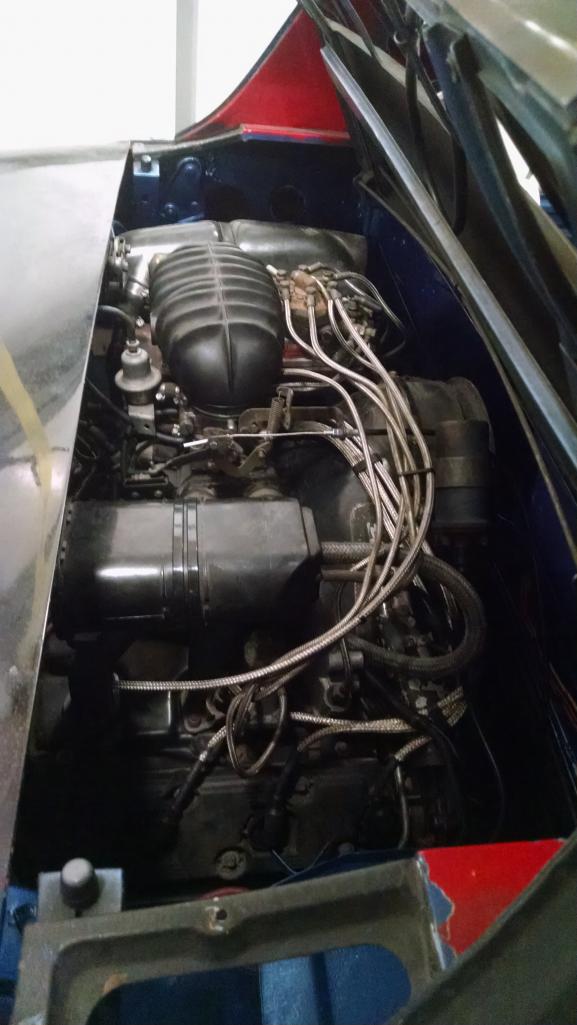

I will be using the patrick motorsports linkage and I am already seeing an issue. The sheet metal from restoration design looks to be using the stock location for carbs which pushes the throttle closer to the center of the engine and has the ball on the inside. CIS throttle has it on the outside. I believe some needed to drill out the ball and tap it on the opposite side. Did they also need to drill a new hole? Did anyone get it working with less effort? Maybe just drill a hole further towards the outside of the engine and not mess with the ball on the throttle shaft. Show me what you did if you can, I'm a visual learner (IMG:style_emoticons/default/beer3.gif)

Here's a pic of my 2.7 with CIS. It uses a 4cyl cable. I cannot claim credit for the bracket. PO made a little bracket which allowed the use of the cable. Only mod on my part was drilling a hole in the 914-6 tin, adding a grommet for the cable to run through.

nditiz1   I just drilled a hole next to the factory throttle...   Sep 16 2021, 10:32 AM
