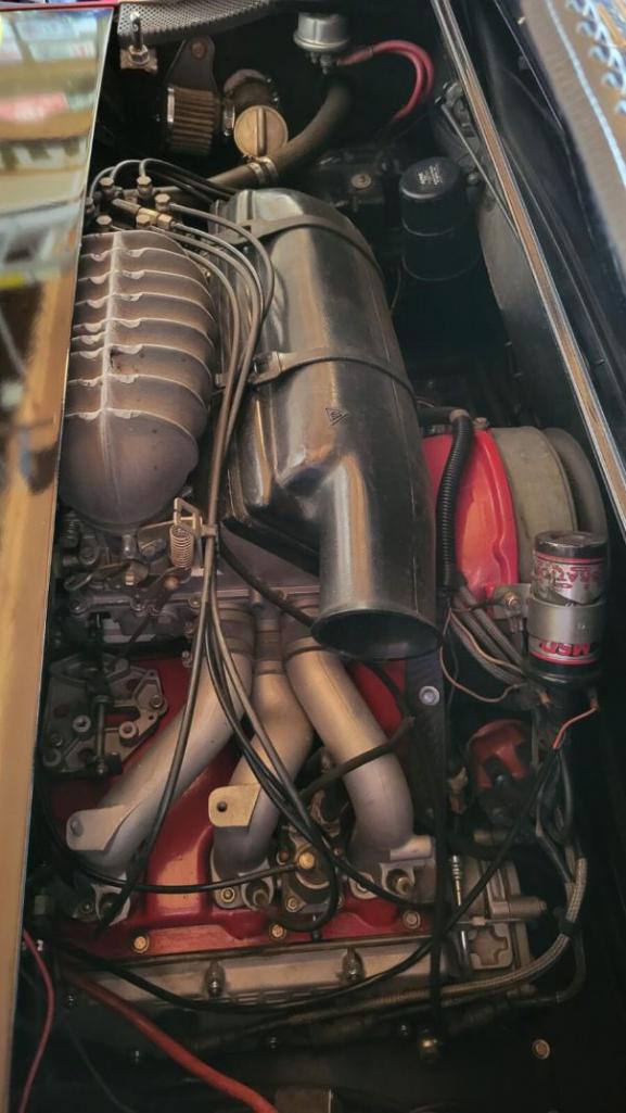

I will be using the patrick motorsports linkage and I am already seeing an issue. The sheet metal from restoration design looks to be using the stock location for carbs which pushes the throttle closer to the center of the engine and has the ball on the inside. CIS throttle has it on the outside. I believe some needed to drill out the ball and tap it on the opposite side. Did they also need to drill a new hole? Did anyone get it working with less effort? Maybe just drill a hole further towards the outside of the engine and not mess with the ball on the throttle shaft. Show me what you did if you can, I'm a visual learner (IMG:style_emoticons/default/beer3.gif)
Thanks all!

Root_Werks   Here's a pic of my 2.7 with CIS. It uses a 4c...   Sep 15 2021, 08:41 AM

VegasRacer   John did you drill a new hole? Looks like every...   Sep 15 2021, 11:06 AM

Root_Werks   I think you can use a 914-6 bell crank with most o...   Sep 15 2021, 01:58 PM
nditiz1   This is the issue with it lining up.   Sep 15 2021, 03:47 PM

ClayPerrine   Here are some pictures from an old thread on a CIS...   Sep 16 2021, 06:33 AM
nditiz1   I just drilled a hole next to the factory throttle...   Sep 16 2021, 10:32 AM
