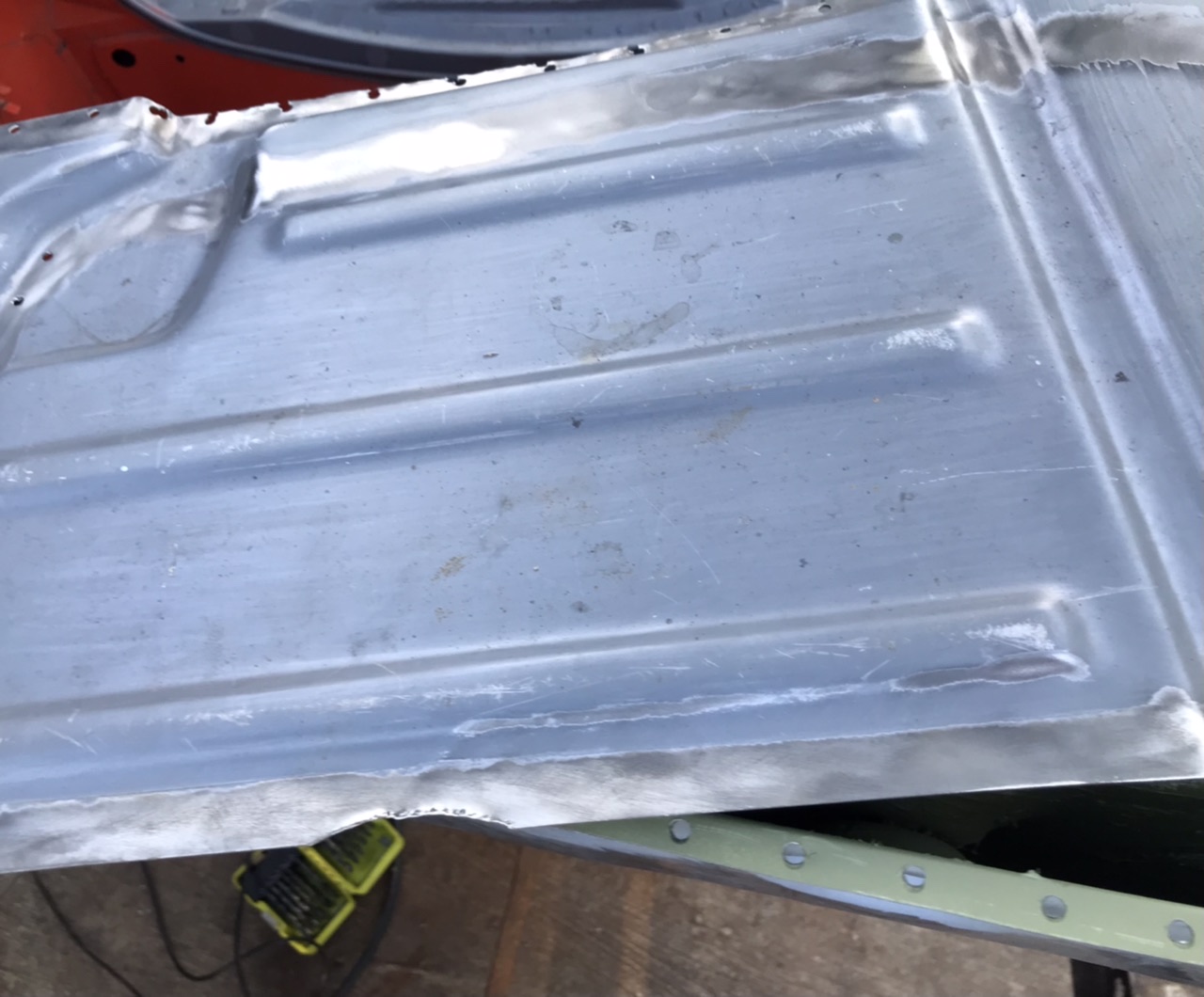

Rusted through areas of the floor and firewalls are officially replaced. We have fresh clean metal there and buttoned up now - feels like a bit of a milestone.
I used the internal frame paint (shown earlier) as weld thru primer between the floor and tunnel/firewall sections, which is high in zinc and worked out great. I welded these panels on the outside of the car as well as the inside.. probably over kill but at least I can say it’s thoroughly done.
