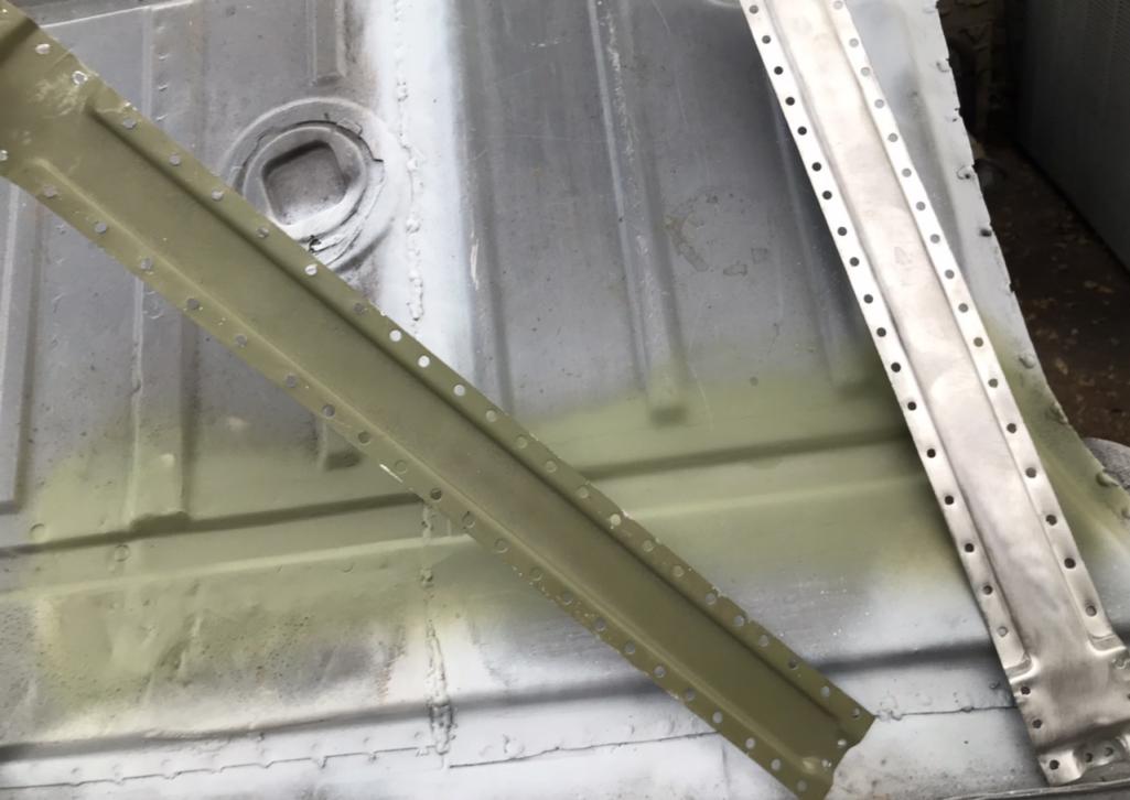

Ok so I installed the external seat supports .. coated the internal side with internal frame paint.
