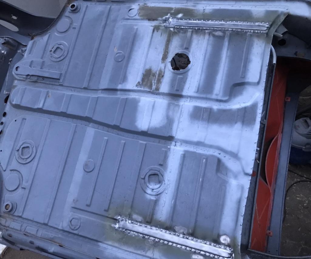

Literati914   Rusted through areas of the floor and firewalls ar...   Sep 27 2021, 07:41 PM
Literati914   In process   Sep 27 2021, 07:43 PM
Literati914   .. and completed - I’ve got solid floors again ...   Sep 27 2021, 07:44 PM
