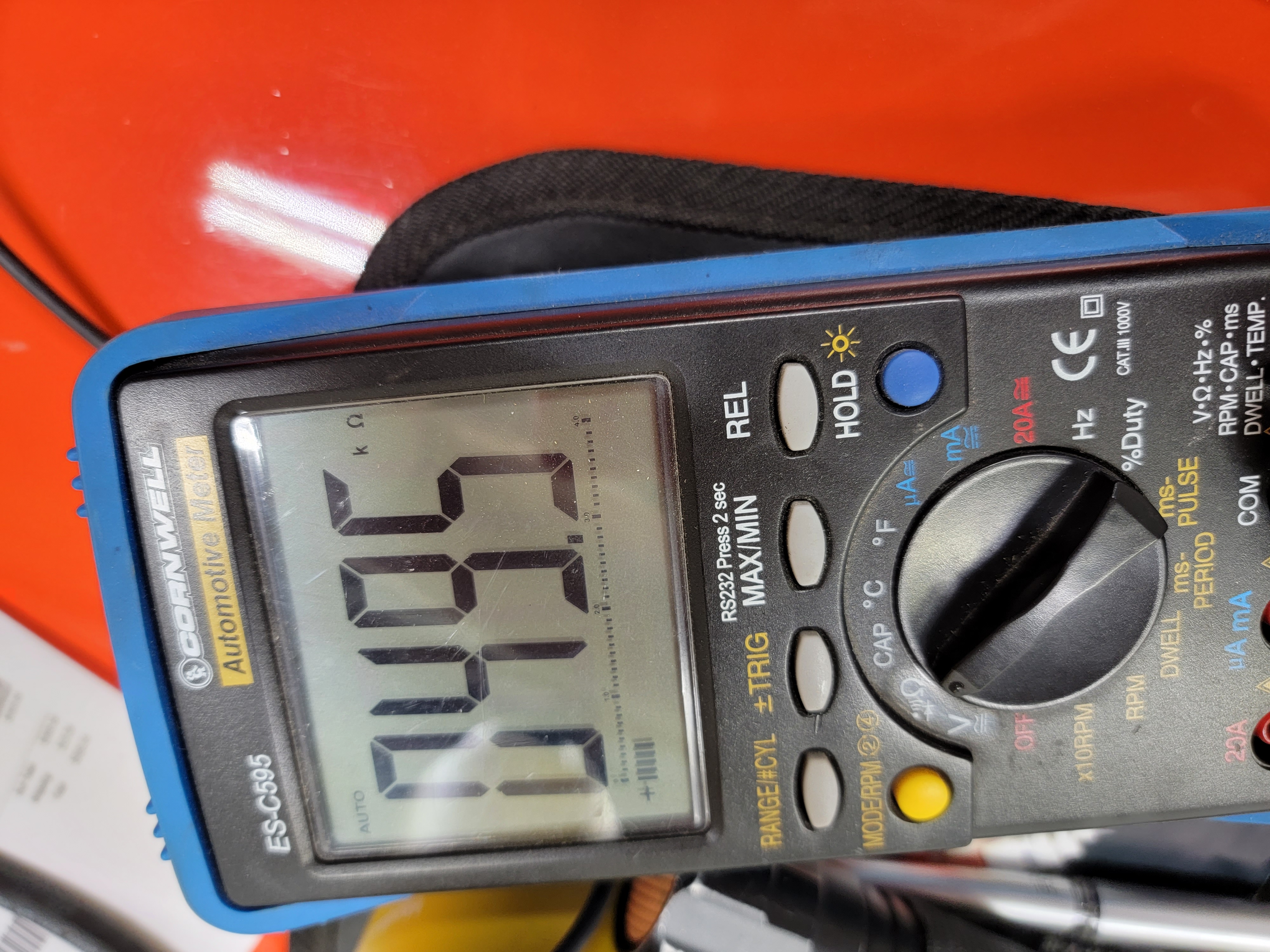

CHT cold (63 degrees F) 49.5K ohms
Well...there's your problem! (At least part of it right?)
Running part 012 from 914Rubber. According to PBanders I should be at 2.85K ohms at 61F. Previously tested good but now it doesn't.
Still testing the rest of the above items.
Thoughts?
