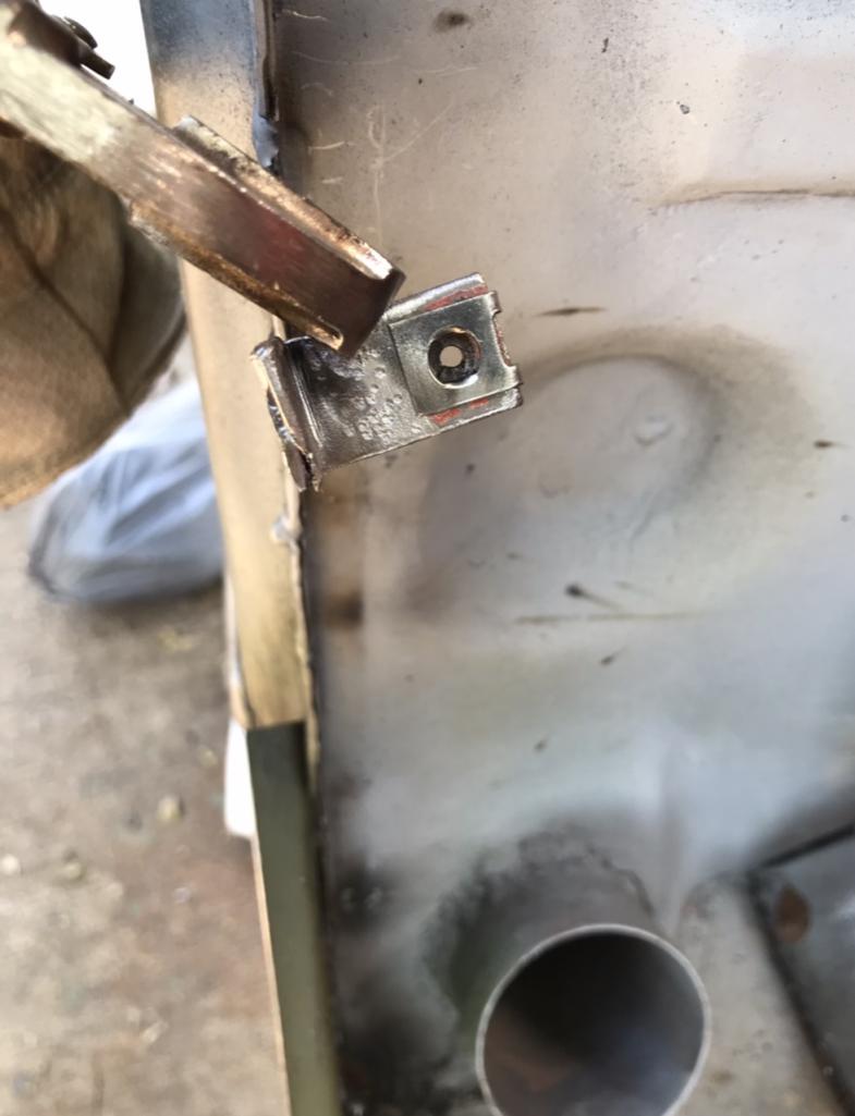

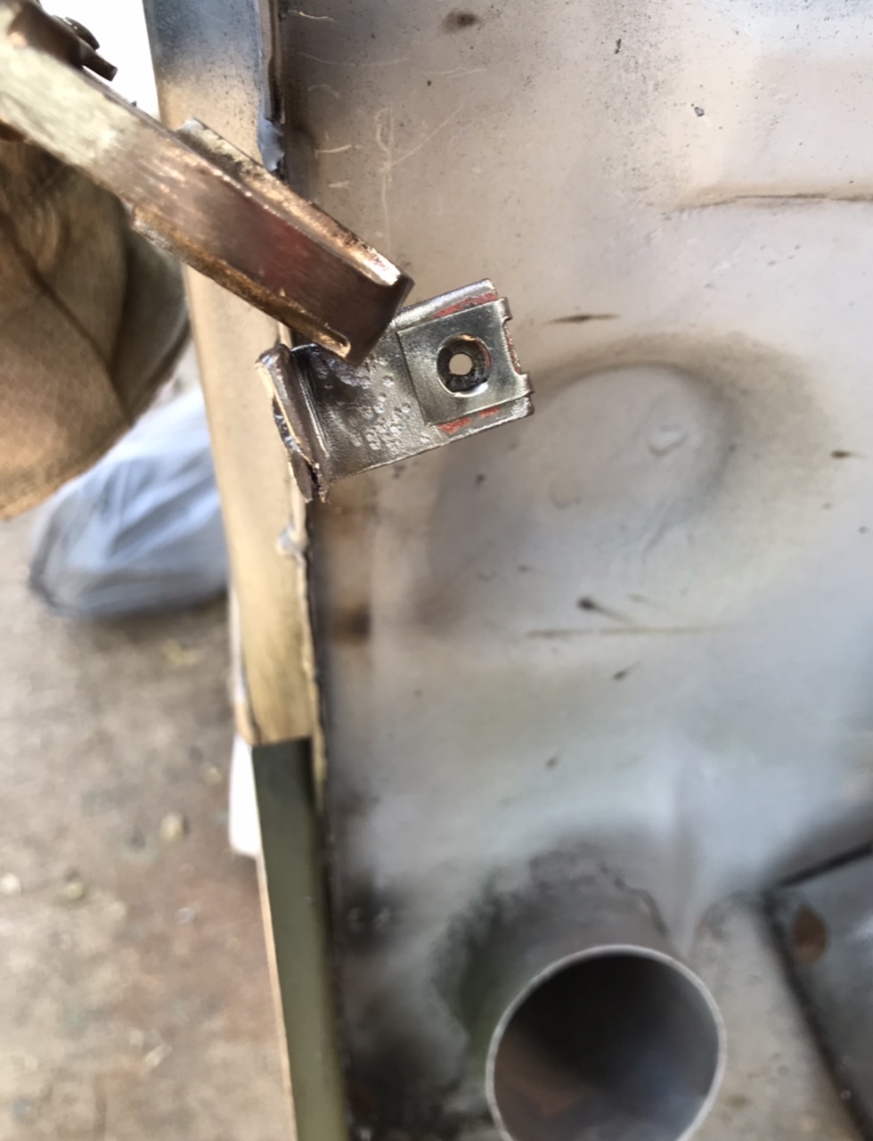

Got a couple small items checked off the list
The little bracket that holds the long parking brake cable.. I finally figured out where exactly it mounts but honestly I kind of just guessed at which direction it was supposed to sit (couldn’t find a clear pic, but pretty sure this will work)

Literati914   Got a couple small items checked off the list The...   Sep 30 2021, 06:51 PM
Literati914   Installed :   Sep 30 2021, 06:52 PM
