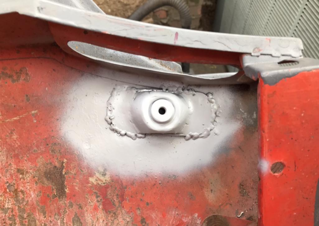

Literati914   .. then it was on to that pesky PS rear hinge (rea...   Sep 30 2021, 06:58 PM
Literati914   Got it measured out and located properly before we...   Sep 30 2021, 07:00 PM
