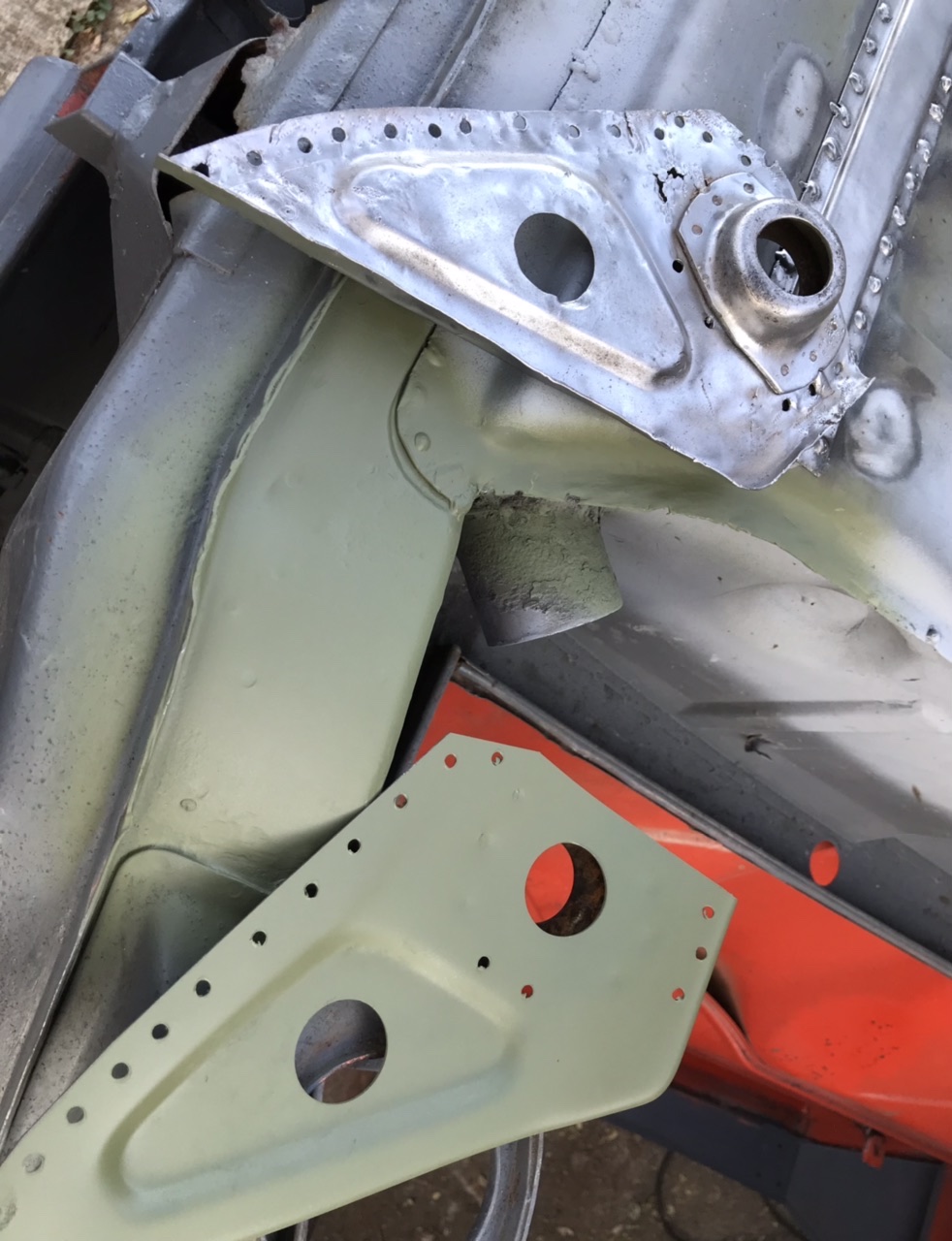

The bigger accomplishment tho, was getting the corner brackets (w/ jack donuts) installed. Before:

Literati914   The bigger accomplishment tho, was getting the cor...   Sep 30 2021, 07:05 PM
Literati914   Installed… I reused the DS one so it’s not as ...   Sep 30 2021, 07:07 PM
