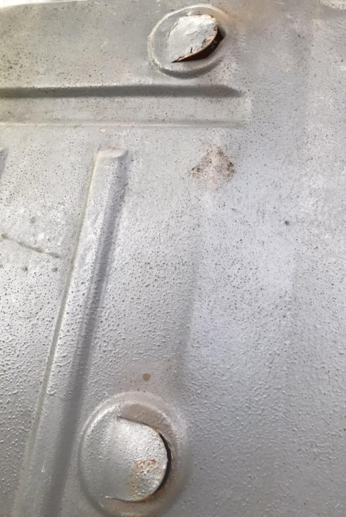

Been wet for a couple days but I was able to get out and weld up those annoying factory placed openings in the floor. These -

Literati914   Been wet for a couple days but I was able to get o...   Oct 2 2021, 07:26 PM
Literati914   After..   Oct 2 2021, 07:27 PM
Literati914   .. next I’ll be patching the huge hole in the fr...   Oct 2 2021, 07:30 PM
