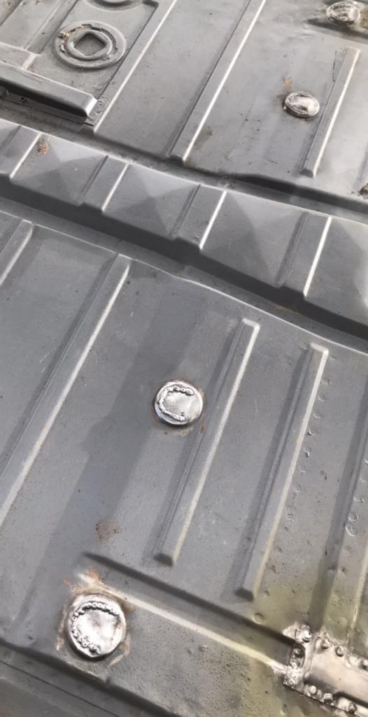

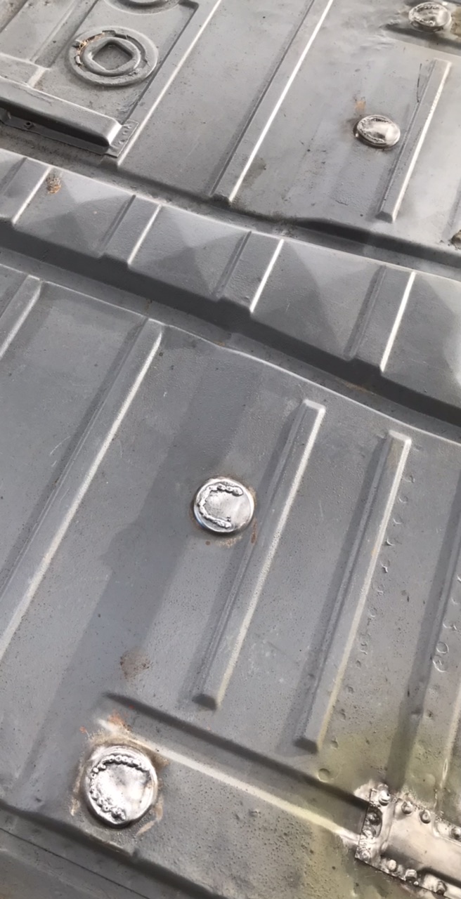

Literati914   My longs are generally in good condition on this c...   Aug 10 2021, 09:41 PM
Literati914   Welded up holes from spot welds and the crack unde...   Aug 10 2021, 09:43 PM
Literati914   ..after phospho acid and primer to the inner layer...   Aug 10 2021, 09:44 PM
