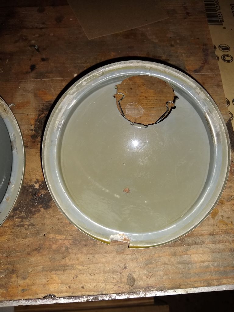

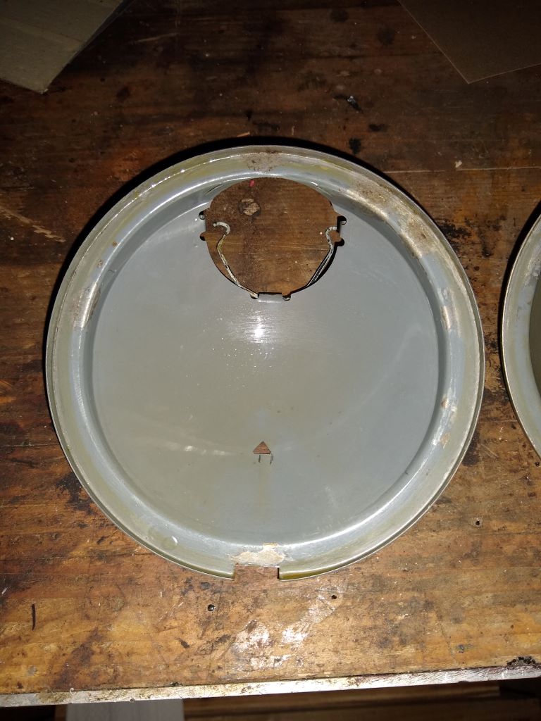

I was trying to address a little bit of rust on the rims of my fog light reflectors, so I dipped the rims in EvapoRust and it took the shinny right off. It looked terrible so I decided to take it all off and start from scratch.
![]() ![]() It looks like there is a layer of paint or sealer that the reflector coating was adhered to. I'm wondering if: 1. Anyplace has these for sale new? 2. Can I just strip and paint with silver paint? 3. Should these things be chromed? Thanks. George |

You could try one of these: https://alsacorp.com/product-category/chrome-paints/
Or send them out to be plated. If you have a local resto shop around, see if they will send them in when they send in theirs. Cheaper if you send in a bunch of stuff, I did an air cleaner lid on an old T-Bird, $200.00 minimum on a run. And that was a life time ago, don't know what it would be now. |
