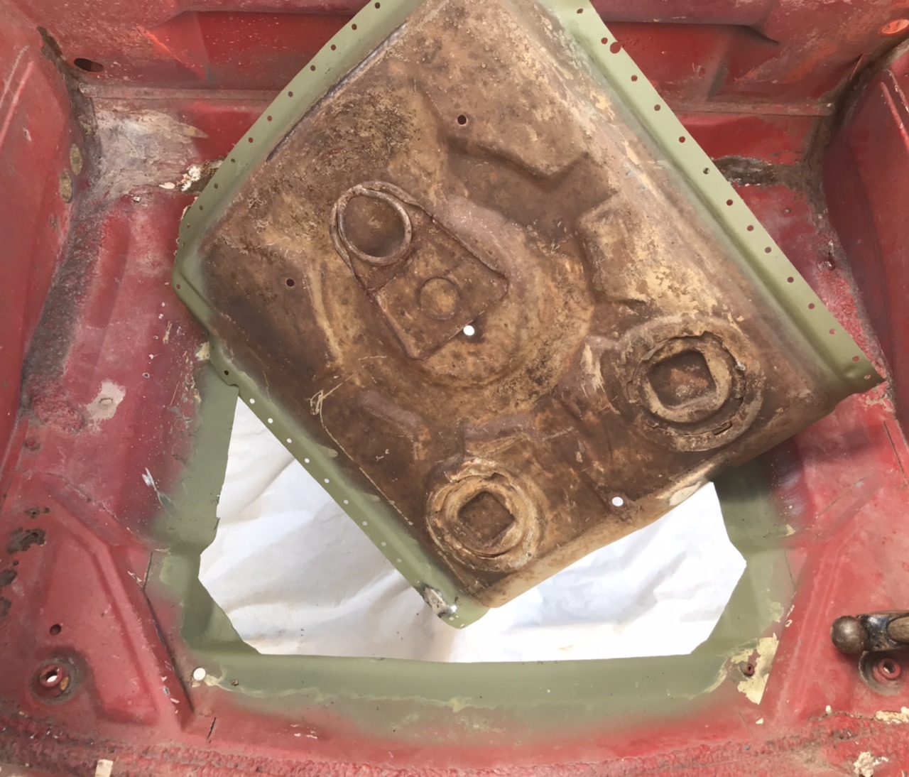

Literati914   Frunk floor replacement panel ready to install.. i...   Oct 3 2021, 06:41 PM
Literati914   .. not my best welds, as I had trouble chasing goo...   Oct 3 2021, 06:43 PM
Literati914   .. the inside side :D , I’ll go back and seem s...   Oct 3 2021, 06:44 PM
