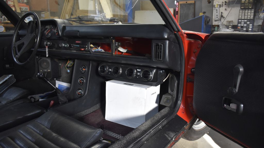

Here's a dry fit of the VintageAir evaporator. Seems to look good once that box is removed. Attached ImageGlove box needs bottom trimmed. Any suggestions for refrigerant hose routing? Mark is looking for ideas and photos from other installations.

Warren914   Here's a dry fit of the VintageAir evaporator....   Oct 4 2021, 08:49 AM
76-914   Run the hoses alongside the passenger side long be...   Oct 4 2021, 09:28 AM
