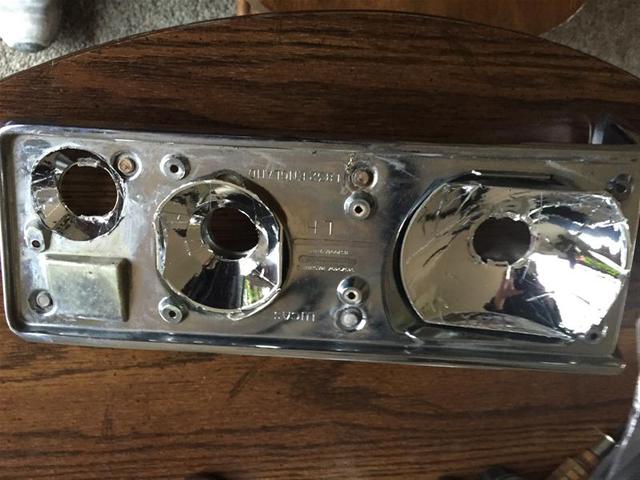

As a stop gap in the past, I resurfaced the insides of several lamp assemblies with aluminum A/C duct tape. It is highly reflective and with care can be molded to surfaces with great results.

As a stop gap in the past, I resurfaced the insides of several lamp assemblies with aluminum A/C duct tape. It is highly reflective and with care can be molded to surfaces with great results. Ansbacher Here's a Triumph TR6 rear light fixture with the A/C reflective duct tape. Looks pretty good. Attached image(s)
