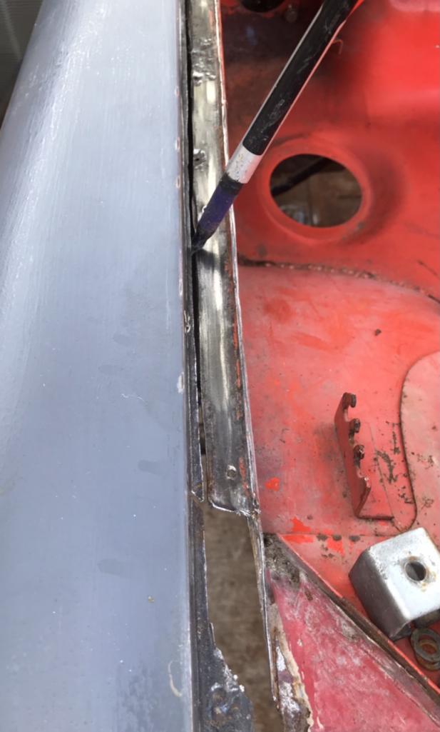

This next issue is a doozy… this car was in a front end accident in its previous life and the geniuses that made the repair, decided to graft a front section (of another 914) on in such a way that the seal channels (from the doner) we’re sitting down inside the old seal channels, and lightly tacked in (IMG:style_emoticons/default/headbang.gif) . This caused all kinds of issues… not the least of which was that the seals no longer would sit low enough for the frunk lid to close properly. So I’m in the process of reversing this - ive cut away the excess doner metal in the channel and the excess original metal and am welding them together to correct the height and hood alignment issues. In the following pic you can see a long cut where my pen is pointing- doner metal on the left, original on the right. Then below that, of course you can see a section of missing metal - where rust ate thru because of the over-lap of the “repair”.
