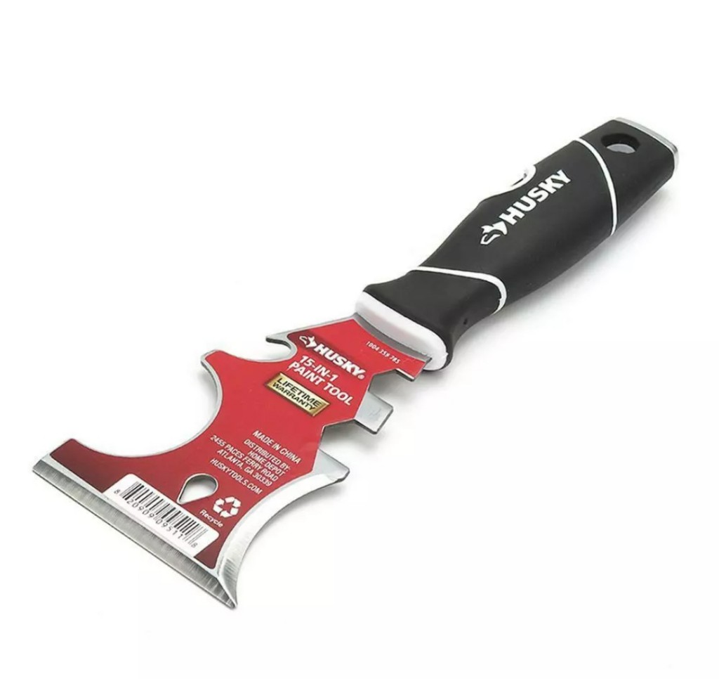

Did the @mikey914 method this evening and it was not that bad once you develop a rhythm. Tabs were missing on mine. Went for it anyways. 2 hrs and done. Was fortunate my windshield is out as a quick clamp came in handy to pull the rubber tight into the small radius section at the top which was the tough part. Tool of choice was an old painters scraper dulled down on the edge. Used the square pointed corner to push and feed the rubber into the outer channel edge small bites at a time. Glycerin for the lube. Thank you all for the posts on this thread.
