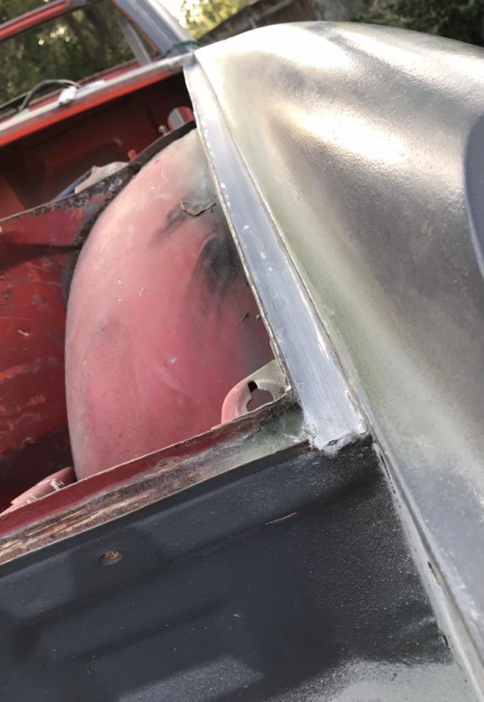

Literati914   .. it was the same story on the driver's side,...   Oct 8 2021, 08:27 PM
Literati914   I stripped down the back side of my stock heat shi...   Oct 11 2021, 07:03 PM
