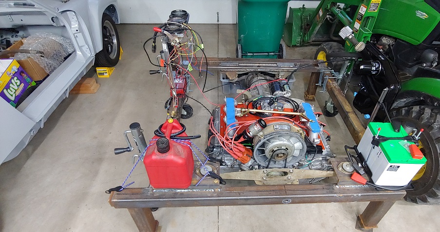

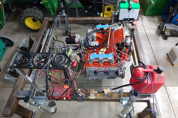

Luke M   We got the 3.0 on the test stand today. I'm go...   Oct 10 2021, 05:44 PM
Luke M   Fired up the 3.0 tonight... She's a runner and...   Oct 14 2021, 07:29 PM
