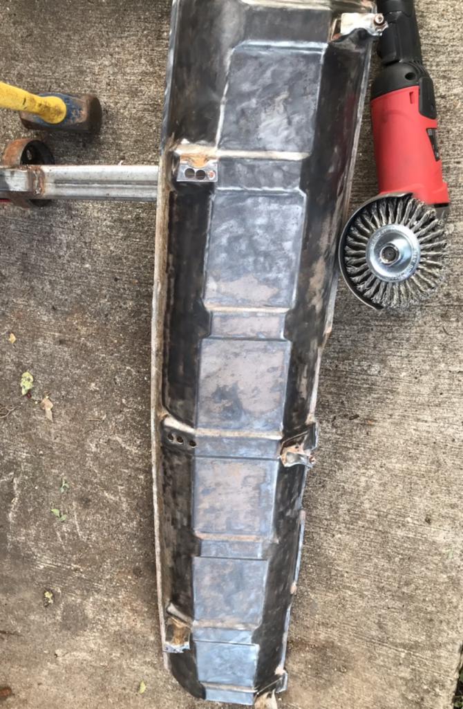

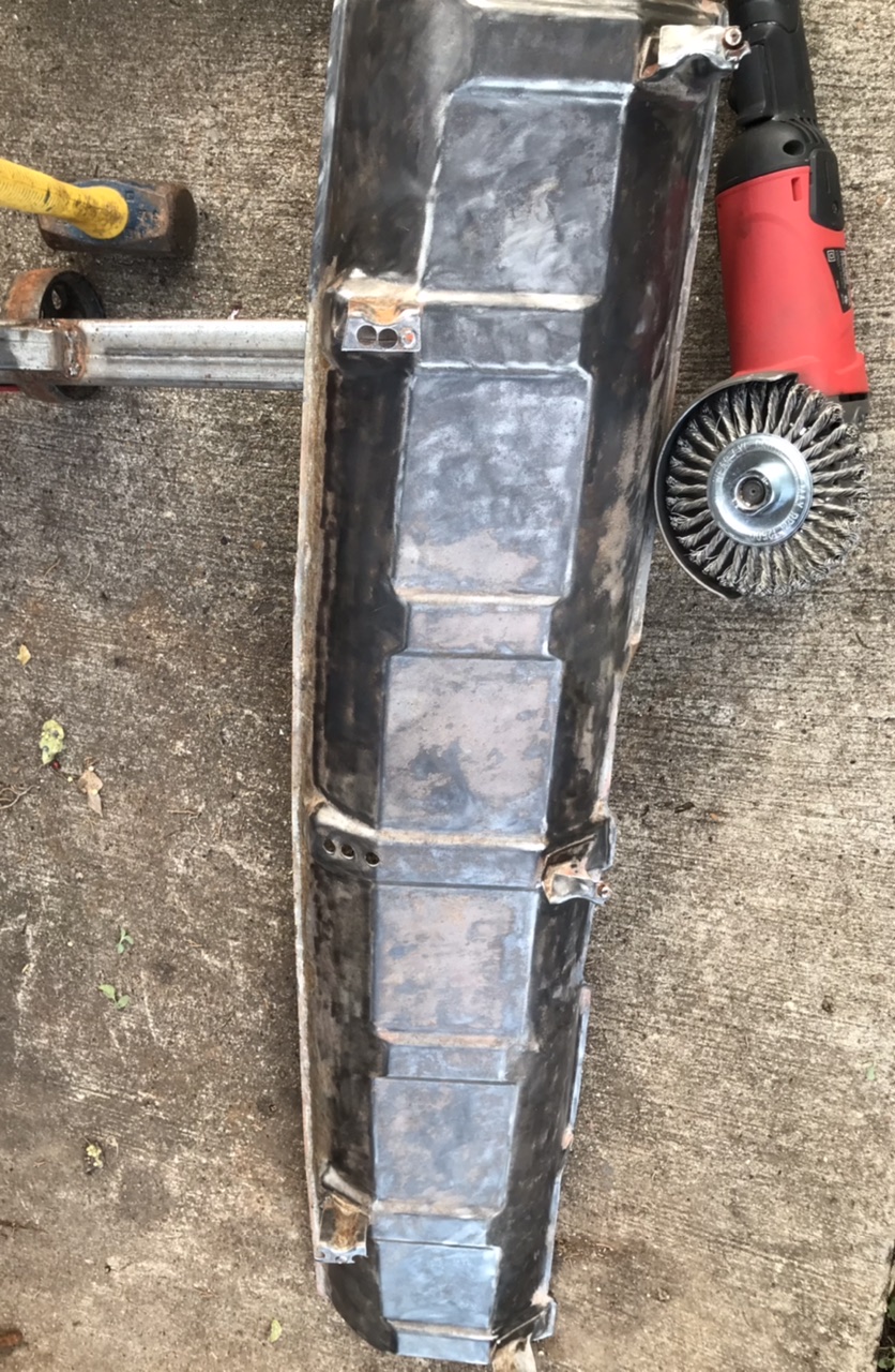

Literati914   This next issue is a doozy… this car was in a fr...   Oct 5 2021, 08:04 PM
Literati914   .. it was the same story on the driver's side,...   Oct 8 2021, 08:27 PM
Literati914   I stripped down the back side of my stock heat shi...   Oct 11 2021, 07:03 PM
