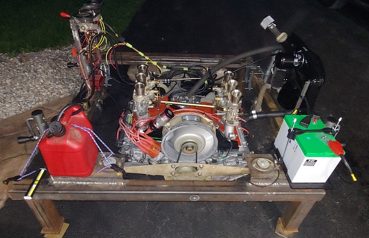

Fired up the 3.0 tonight... She's a runner and sounds sweet. (IMG:style_emoticons/default/piratenanner.gif)
If I only knew how to post a video clip here. I guess a pic will have to do for now.
