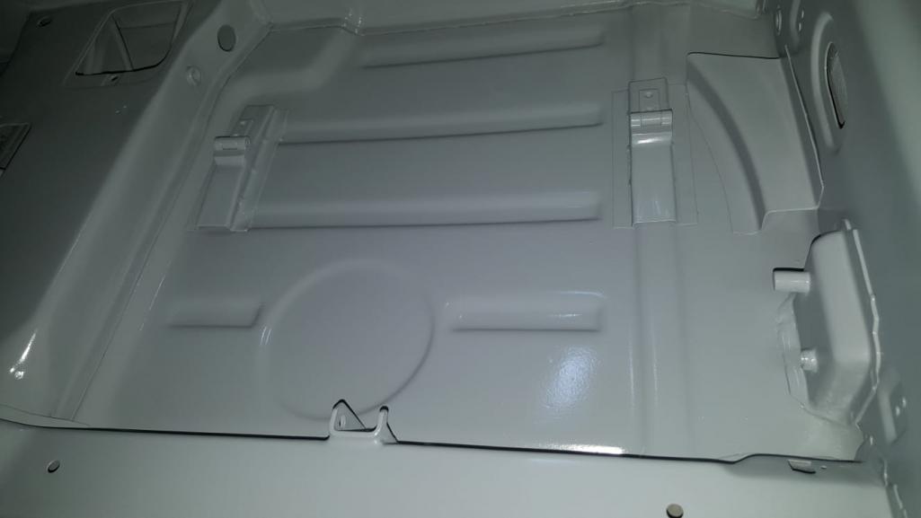

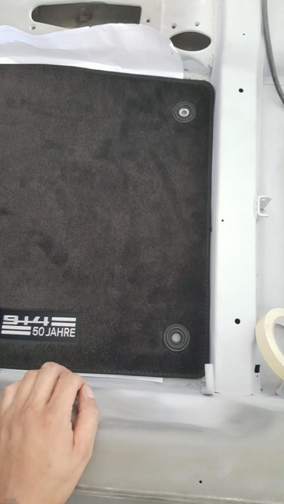

I still had to take care of some details for the floor so I thought this was a good time to get them off my list. I needed to add the hand brake cable guide and the rear bracket for the small cover.
Then I had to make some of the little posts to hold the floor mats in place.
All finished on the inside and now it is basically ready for paint, finally (IMG:style_emoticons/default/blink.gif)
