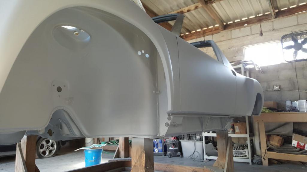

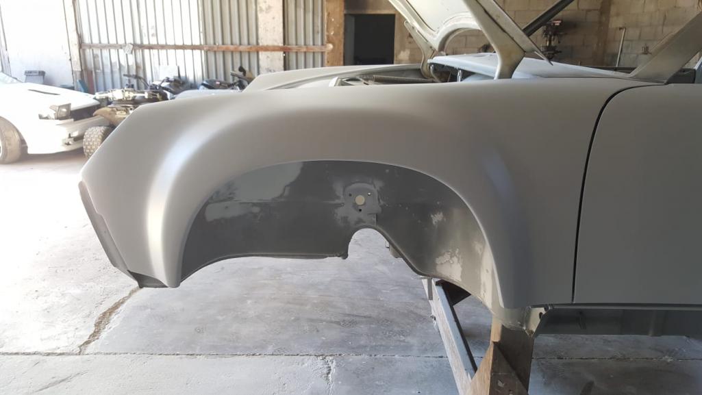

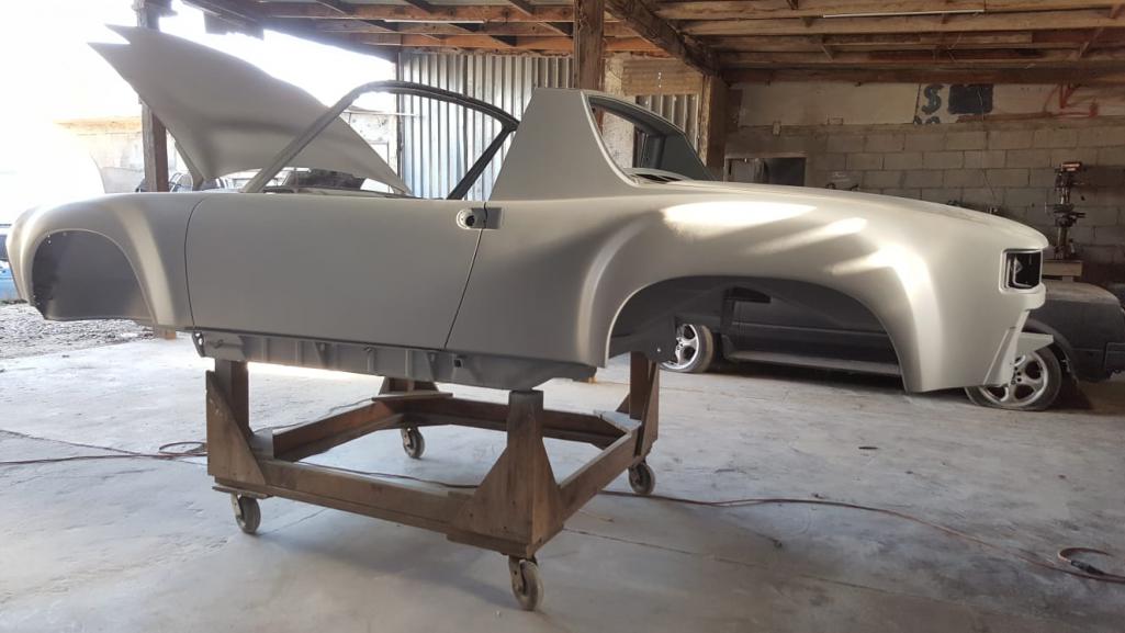

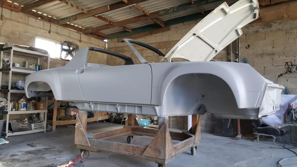

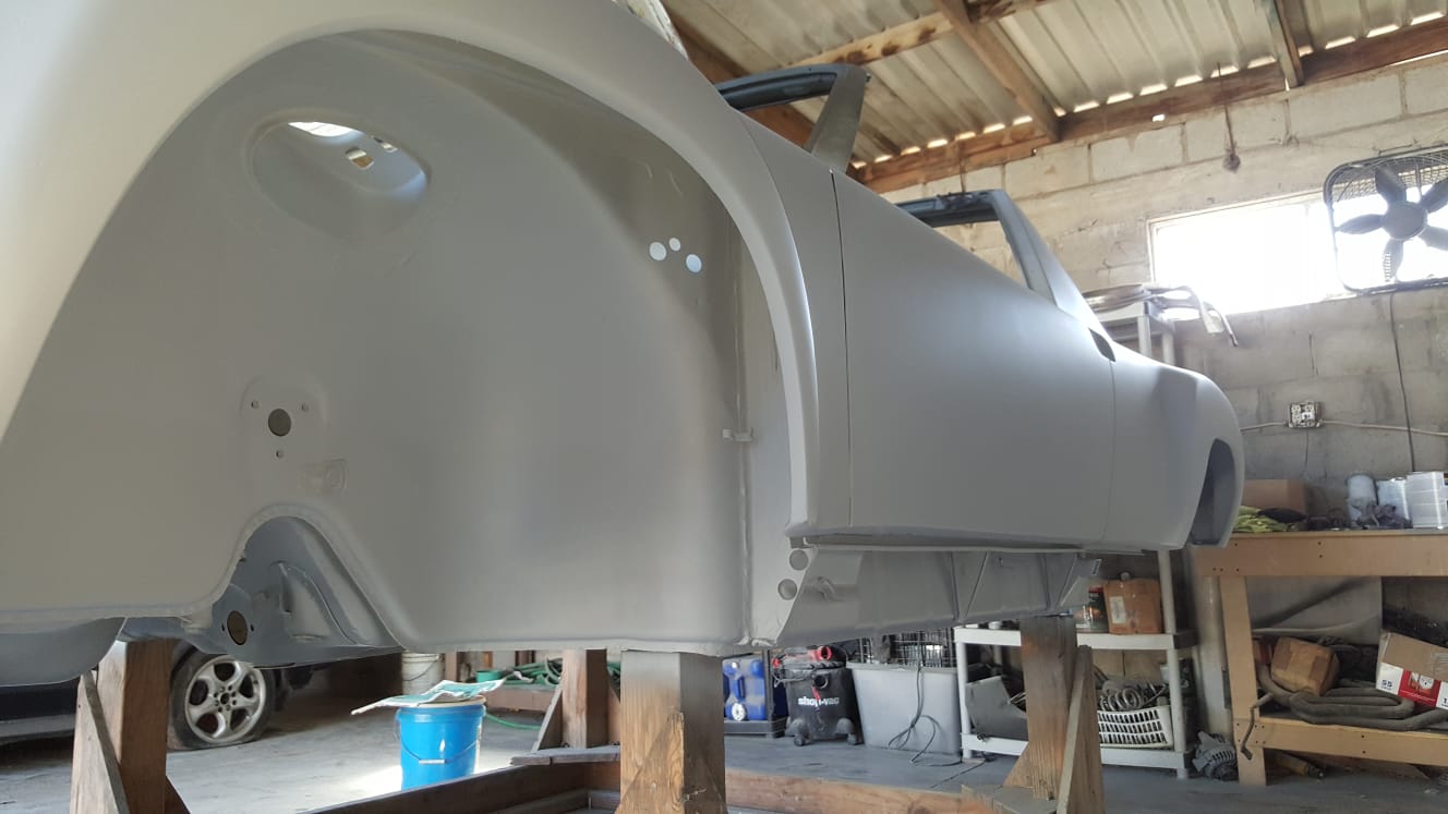

I turned my attention to the wheel wells to make them nice and pretty before I spray on the Raptor Liner. I already ordered the tintable 4 liter kit and it should show up early next week.
And some full shots to see it in its current state.
