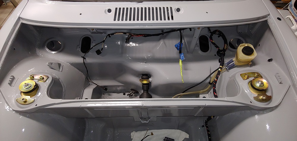

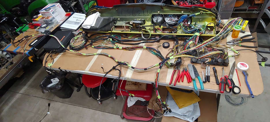

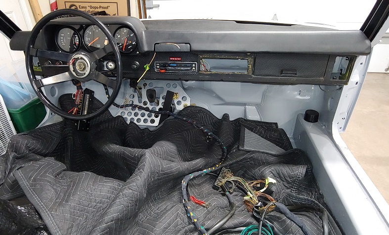

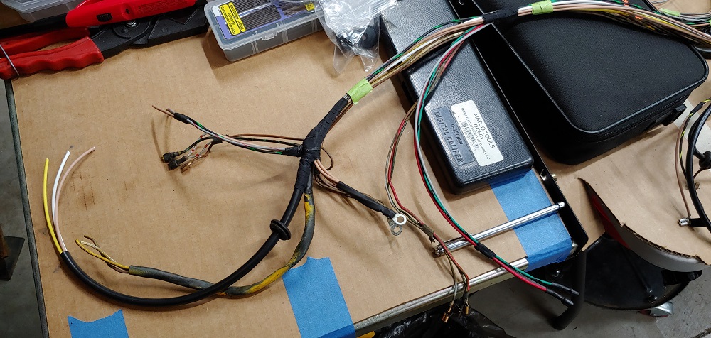

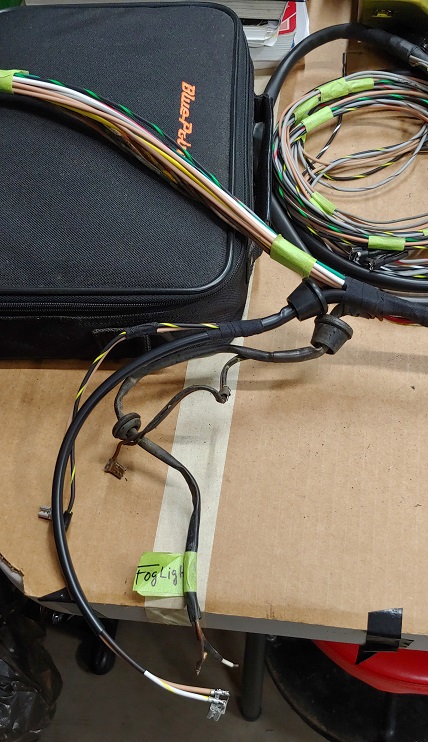

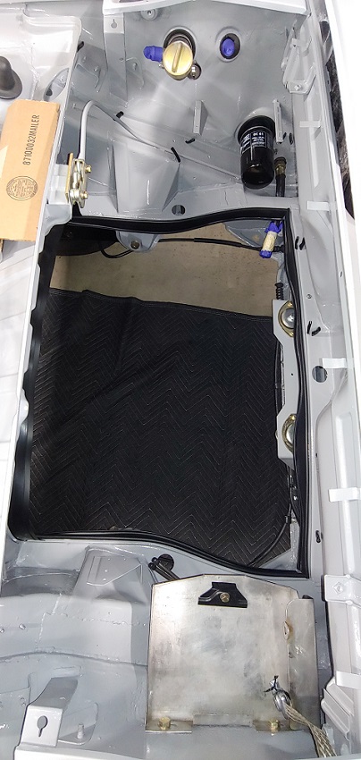

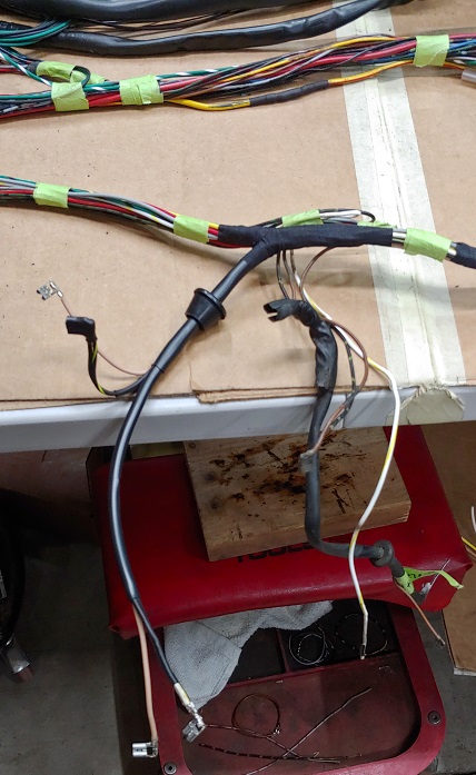

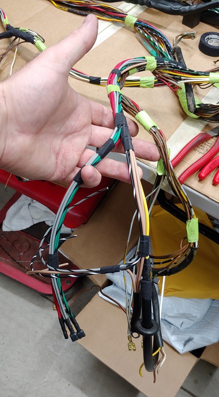

We had a busy weekend here. Got the wire harness all squared away and started to install that along with the dash. Got the 914rubber engine bay seal in, oil filter installed, and ran the 3.0 again. I'll get the wire harness mostly installed on Monday. Anyone remember what the fix was for the 914rubber harness snorkel when used in a later 914? It has a larger diameter hole on the fire wall then the early cars.

Luke M   So I'm stuck with the harness install in the e...   Oct 25 2021, 07:02 PM
rgalla9146   Luke how about this ? Work up the dimension...   Oct 25 2021, 08:10 PM
Mikey914   The fix had been to use a small section of sheet m...   Oct 26 2021, 02:19 AM
