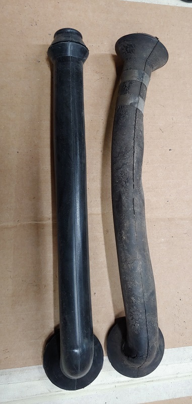

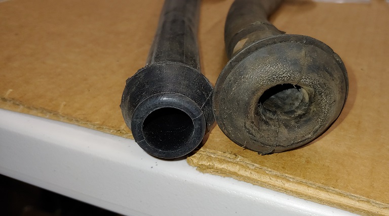

So I'm stuck with the harness install in the engine bay. Anyone know how to fix this issue with the snorkel. I recall seeing something on this several years ago but I can't locate that thread.

Mikey914   The fix had been to use a small section of sheet m...   Oct 26 2021, 02:19 AM
