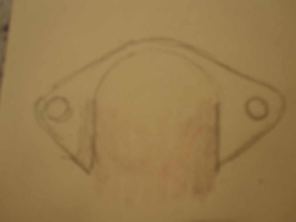

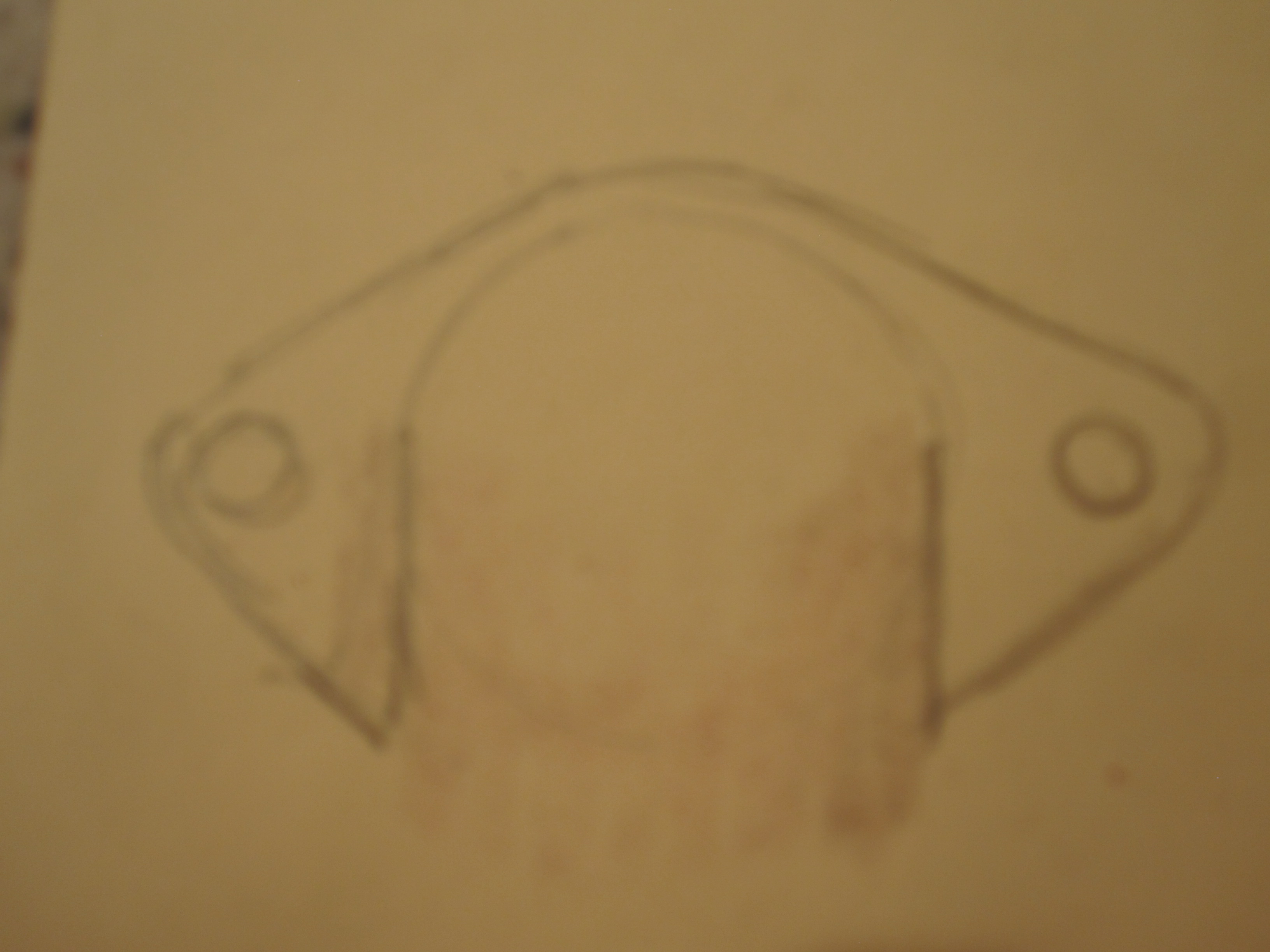

Luke how about this ?
Work up the dimensions from the snorkel and whittle it up from alum sheet.
Can be done with or without the slot. With the slot make two and face them opposite each other. Easy peasy.
The tube can be shortened and glued with contact cement, shrink tube or electric tape.
I employed a ten year old artist. (IMG:style_emoticons/default/biggrin.gif)
