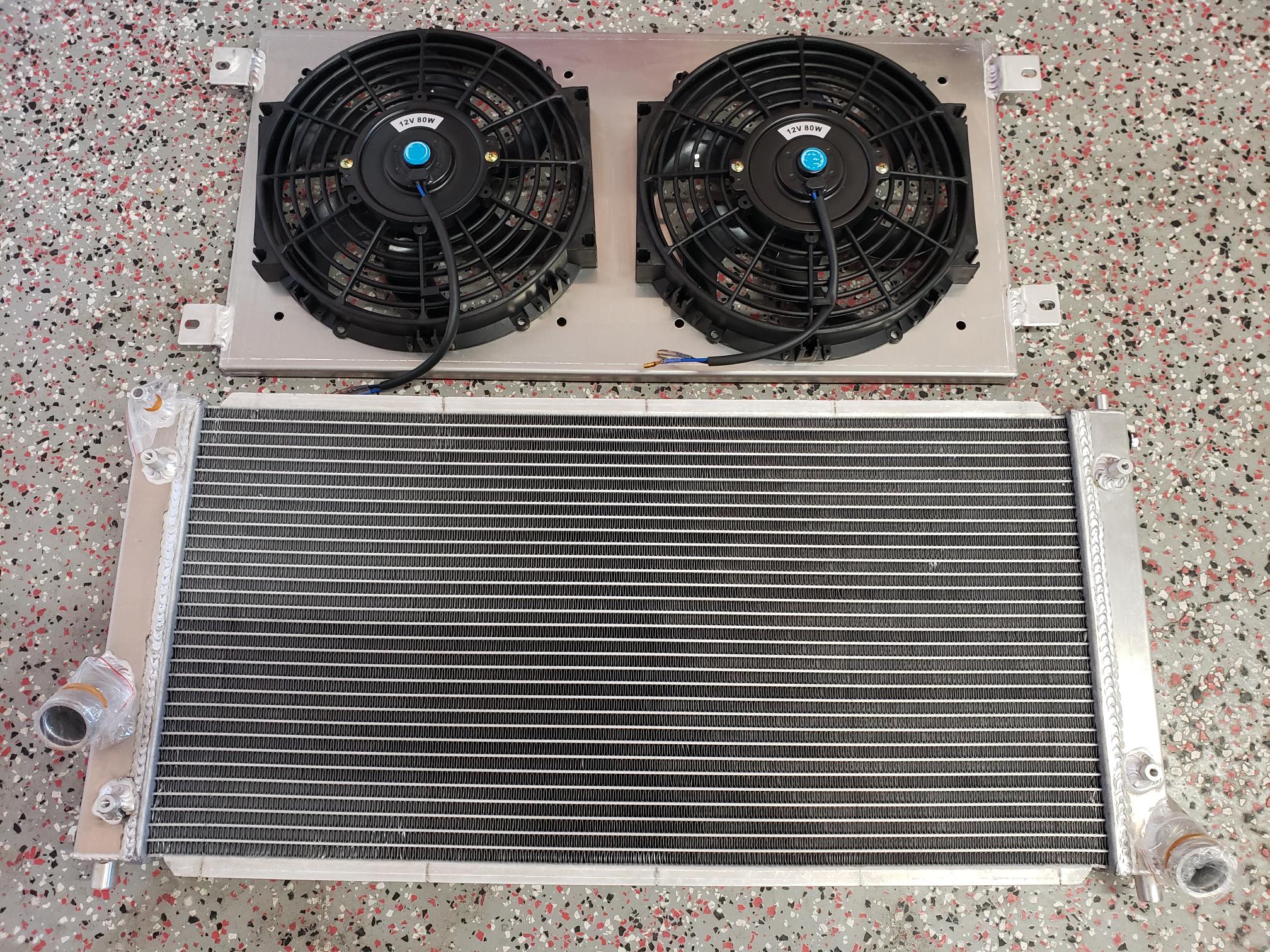

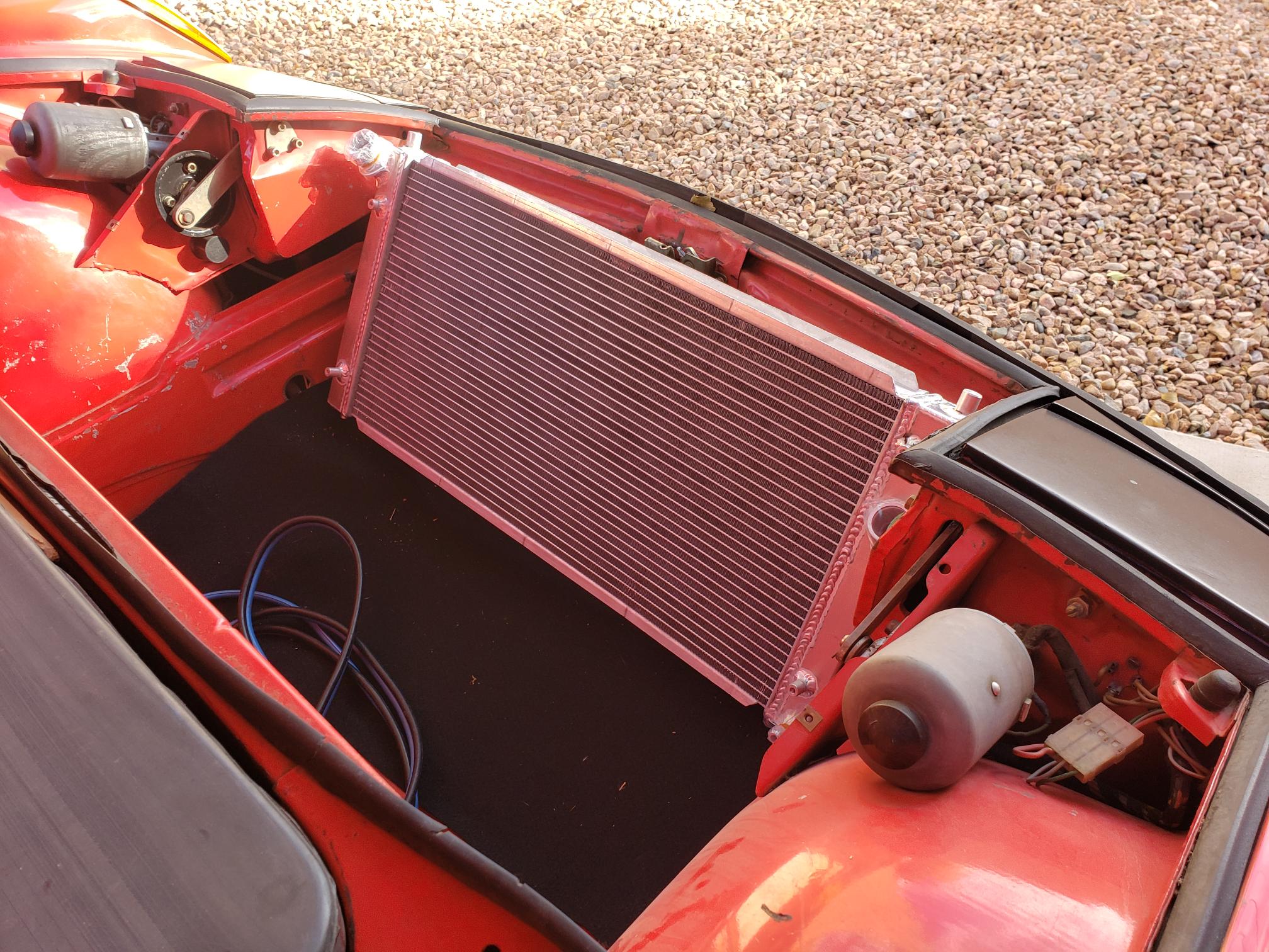

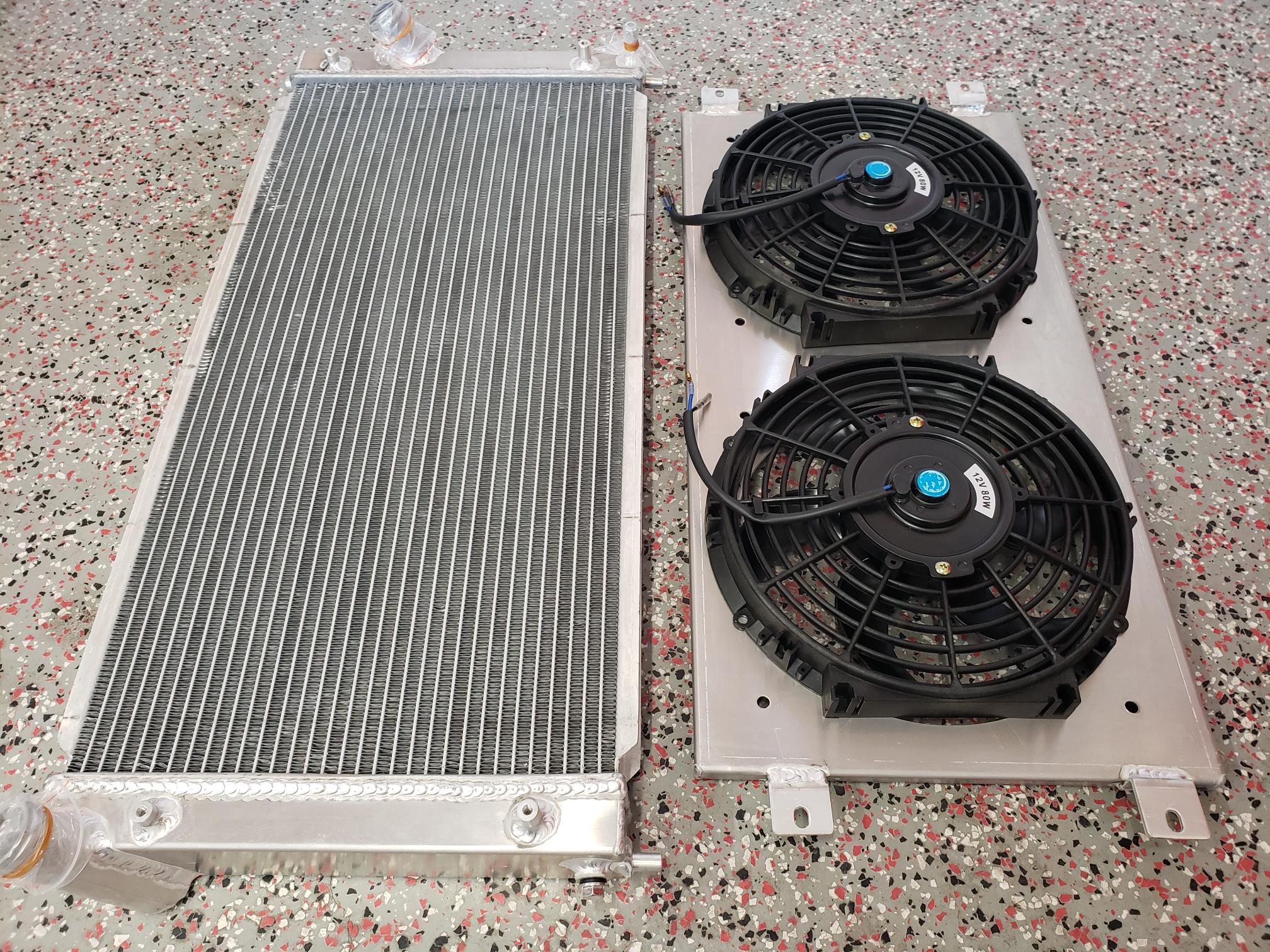

Mayne   In other news, I finally got a new radiator...for ...   Oct 29 2021, 11:18 AM
